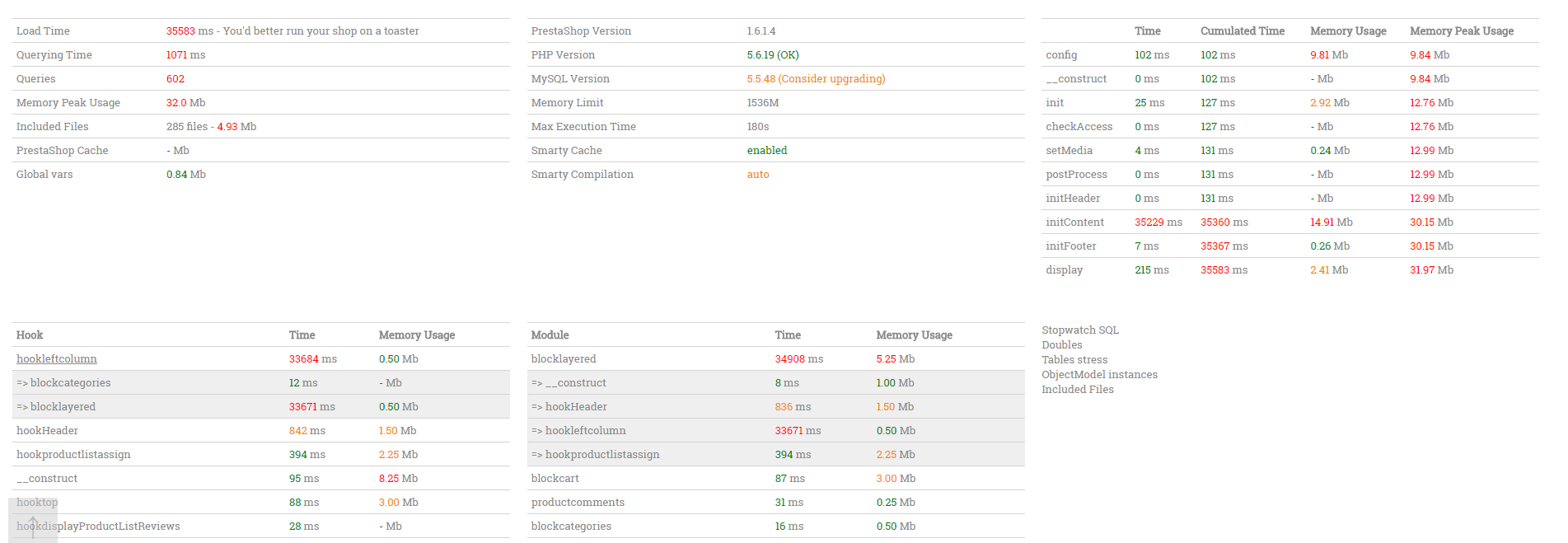

DethGhost Posted April 25, 2018 Share Posted April 25, 2018 Hi to all. I have a problem with site slow loading on page with filters (module blocklayered). Here is profiler for page with selected 5 filters. It's look awfull for me. On other site i have not problem like this. On production server i have it more slow. Page load time about 1-2min. server is vps with 8gb ram, used for 2 sites. Can anyone help me to resolve this problem? Sorry my bad english. And thanks for any advise. Link to comment Share on other sites More sharing options...

DethGhost Posted April 27, 2018 Author Share Posted April 27, 2018 1 hour ago, El Patron said: yes, I meant second.... if still slow, and many products in cat....you may want to consider hosting with more horsepower. uh.... it's hear bad. I'm use VPS with 4core Intel Xenon 5 and 8gb ram, 150gb rom ssd.... and no activity on this site. I think problem not in performace of the server. Can you give me the way i need to look for resole this issue. And if you can, help me understand difference in this lines from profiler: Load Time 299268 ms - You'd better run your shop on a toaster Querying Time 1181 ms Link to comment Share on other sites More sharing options...
