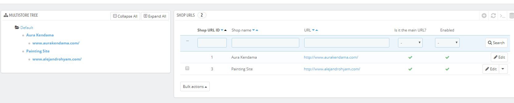

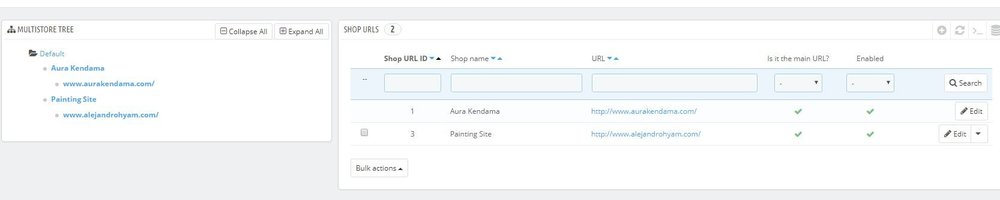

ilegales Posted March 14, 2019 Share Posted March 14, 2019 (edited) On 11/16/2017 at 10:23 PM, vkmaxx said: OK, I solved it. The problems was that entering web page without www was not lunching multistore script, the solution was to add: RewriteCond %{HTTP_HOST} !^www\. RewriteRule ^(.*)$ http://www.%{HTTP_HOST}/$1 [R=301,L] just after <IfModule mod_rewrite.c> <IfModule mod_env.c> SetEnv HTTP_MOD_REWRITE On </IfModule> RewriteEngine on More information about this problem Hi I have added this text as shown to the htaccess file Still have the problem first shop works both www and non www used (example - petersmith com and www.petersmith com) Second shop only works when the same url name is written in the multishop url See enclosed photo so on this example the second shop has (http://www.alej.......com) but non www does not work (http://aleja........com should i post the htaccess file ?? what i would like to get working is both www and non www to work site 1 - www.aurak.....com aurak....com site 2 www.aleja.....com aleja...com I also have one htaccess and one htaccess_bk file which one to edit? Edited March 15, 2019 by ilegales (see edit history) Link to comment Share on other sites More sharing options...
