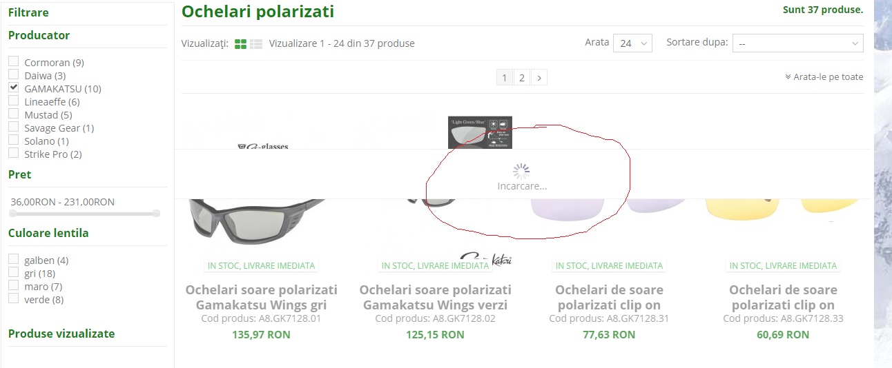

webbusiness23 Posted July 15, 2016 Share Posted July 15, 2016 Hello, i've just noticed that my "Layered navigation module" on Presta 1.6 is not working anymore. When i click on a filter (brand or any other filter that i defined), it just keeps staying on "loading" and nothing happens. (see attached pic) Can you help me solve this, please? Link to comment Share on other sites More sharing options...
Daniel Patilea Posted July 15, 2016 Share Posted July 15, 2016 Hello, i've just noticed that my "Layered navigation module" on Presta 1.6 is not working anymore. When i click on a filter (brand or any other filter that i defined), it just keeps staying on "loading" and nothing happens. (see attached pic) Can you help me solve this, please? I've seen that you have a 500 error in your console log. You can try to set permissions to the module (755 to folders and 644 to files). If still doesn't work check the error_log file from your website's root folder. Link to comment Share on other sites More sharing options...
webbusiness23 Posted July 15, 2016 Author Share Posted July 15, 2016 Everything worked just fine until this morning. I've made no changes to the source code. Is the "500 error" server sided related? Thank you! Link to comment Share on other sites More sharing options...
Daniel Patilea Posted July 15, 2016 Share Posted July 15, 2016 Everything worked just fine until this morning. I've made no changes to the source code. Is the "500 error" server sided related? Thank you! Not really, I think you're having errors with your shop. Set the _PS_MODE_DEV_ to TRUE and you will be able to see that causing the bug Link to comment Share on other sites More sharing options...
