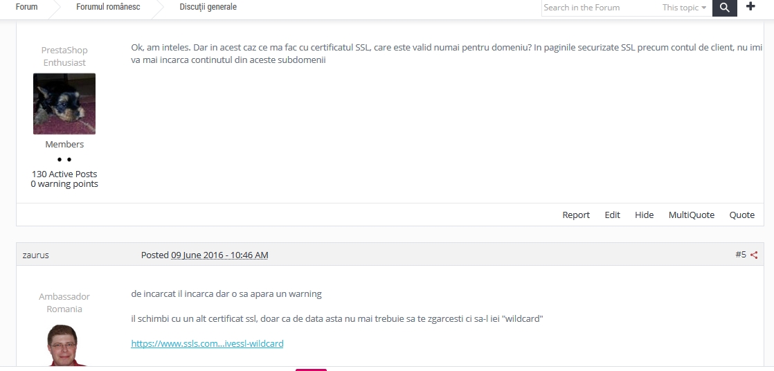

bluestyle Posted June 9, 2016 Author Share Posted June 9, 2016 Ok, am inteles. Dar in acest caz ce ma fac cu certificatul SSL, care este valid numai pentru domeniu? In paginile securizate SSL precum contul de client, nu imi va mai incarca continutul din aceste subdomenii 1 Link to comment Share on other sites More sharing options...
zaurus Posted June 9, 2016 Share Posted June 9, 2016 de incarcat il incarca dar o sa apara un warning il schimbi cu un alt certificat ssl, doar ca de data asta nu mai trebuie sa te zgarcesti ci sa-l iei "wildcard" https://www.ssls.com/ssl-certificates/comodo-positivessl-wildcard Link to comment Share on other sites More sharing options...

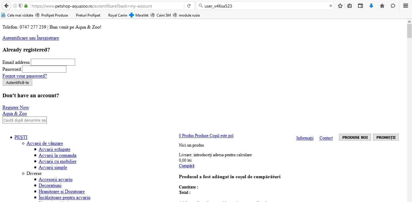

bluestyle Posted June 9, 2016 Author Share Posted June 9, 2016 (edited) Asa imi este afisata pagina unde am SSL Edited June 9, 2016 by bluestyle (see edit history) Link to comment Share on other sites More sharing options...

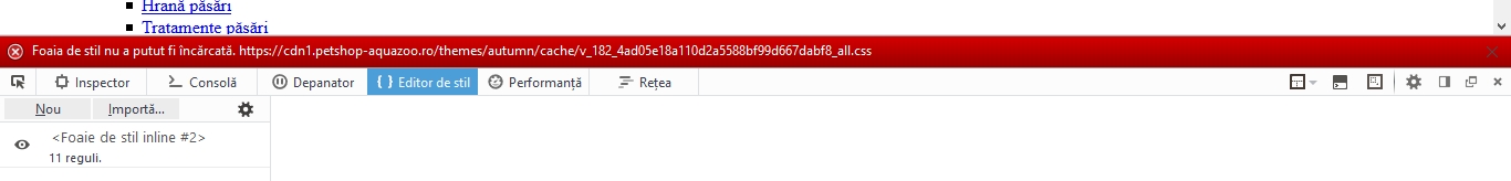

zaurus Posted June 9, 2016 Share Posted June 9, 2016 normal, dupa cum spune si mesajul de eroare... nu a putut fi incarcat css. curata cache. by the way, mie-mi arata corect Link to comment Share on other sites More sharing options...
bluestyle Posted June 9, 2016 Author Share Posted June 9, 2016 Iti arata corect deoarece nu am lasat asa site-ul, am dezactivat cdn-ul. Am golit si cache, aceeasi problema.... Link to comment Share on other sites More sharing options...
