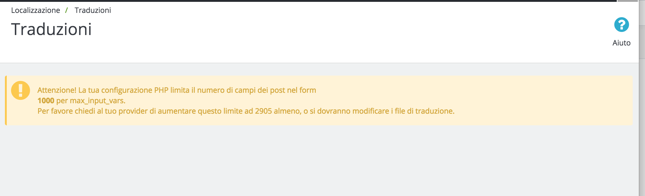

kateclouds Posted May 23, 2016 Share Posted May 23, 2016 Hi everyone, I have an issue I can't solve. Reading the documentation online, I've understood that the error "WARNING, PHP settings limit the maximum number of fields to send in a form: Max_input_vars 1000. Please check with your hosting provider to increase the limit of 2905 at least or edit the translation file manually." Could be solved by changing the max_input_vars value in php.ini to 10000 or higher value. Even if my php.ini seems effectively modified from the administration panel of my provider, I continue to get the same error in Prestashop. I'm running the 1.6.1.5 version, using a template bought on themeforest. The shop is under construction, and it's installed in a subfolder: i.e., nameoftheshop.domain.it; it's in maintenance mode, I've only allowed my ip to always access the website. Thanks a lot for your kind help Caterina from Florence, Italy Link to comment Share on other sites More sharing options...

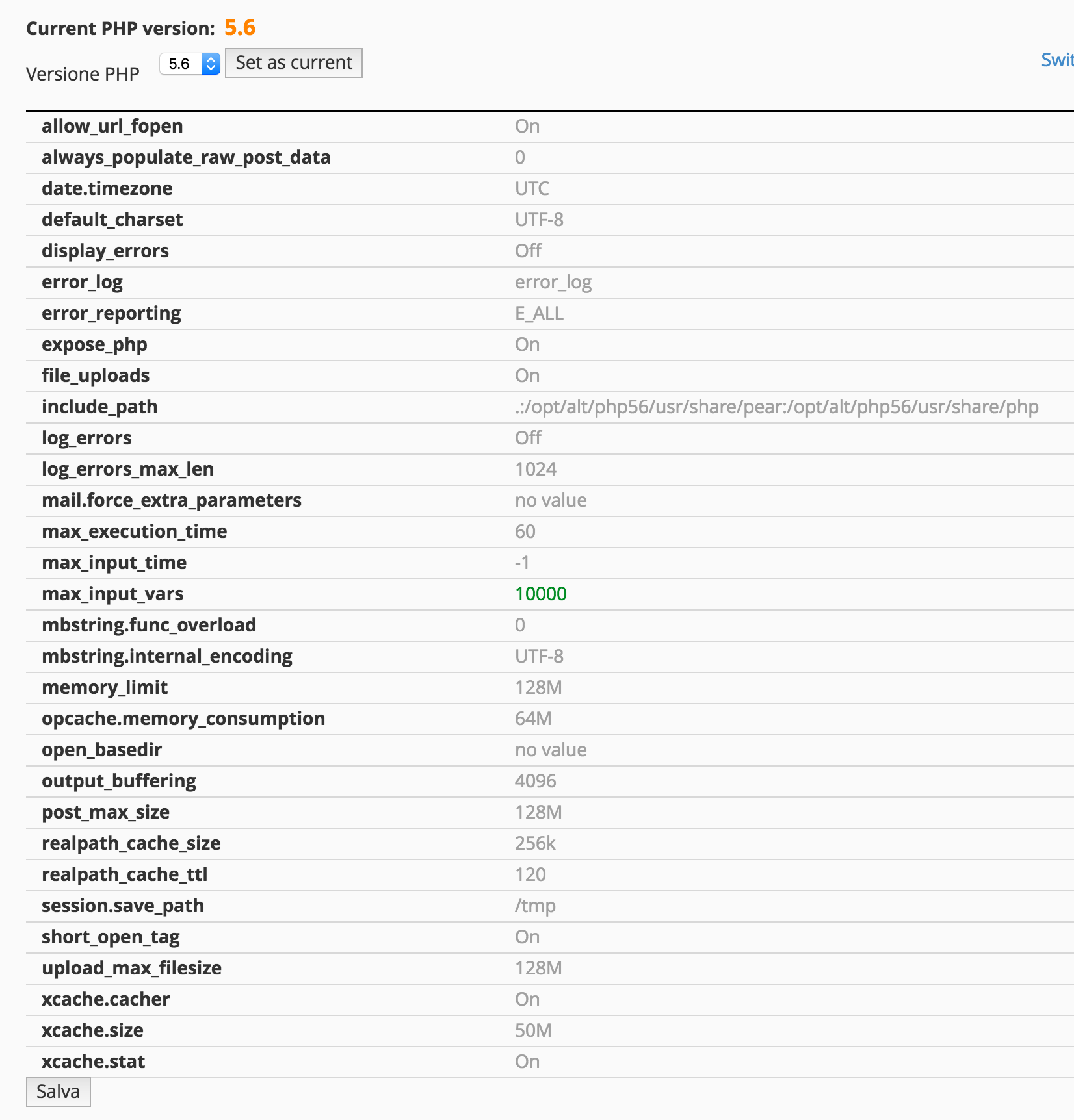

kateclouds Posted May 23, 2016 Author Share Posted May 23, 2016 (edited) Thank you! I followed your instructions, and here it is the result...really, there must be some misconfiguration in the webserver, because the reports are quite different! In Cpanel I see a 10000 value, in the info.php report I see a 1000 value! Can you confirm that this is a misconfiguration due to the provider? That's why they said that it was my fault! http://www.caterinacirri.it/phpinfo()print.pdf http://www.caterinacirri.it/cpanel.png Caterina Edited May 23, 2016 by kateclouds (see edit history) Link to comment Share on other sites More sharing options...
kateclouds Posted May 24, 2016 Author Share Posted May 24, 2016 Dear selectshop.at, can you please confirm from the two samples above, if there is a server misconfiguration or not? So that I can forward it to the provider...thank you! Link to comment Share on other sites More sharing options...
PrestaHeroes.com Posted May 24, 2016 Share Posted May 24, 2016 use this free module to see phpinfo from back office, else you will not know what values are as set at ps runtime https://www.prestashop.com/forums/topic/278164-free-module-display-php-environment-phpinfo-back-office/ on your phpinfo, it shows 1000...with module or 'other' phpinfo, you can find path to php.ini, but as select.at stated, it may not be honored by hosting, i.e. ignored. Then you should contact your hosting company for help. Link to comment Share on other sites More sharing options...
