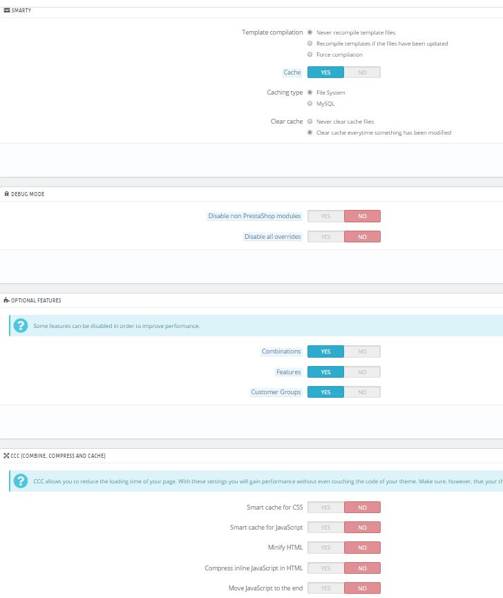

PrestaHeroes.com Posted April 12, 2016 Share Posted April 12, 2016 what is your current version of PS? can you please post screen shot of backoffice-->advanced parms-->performance specifically smarty cache settings. Link to comment Share on other sites More sharing options...

PrestaHeroes.com Posted April 13, 2016 Share Posted April 13, 2016 lol, we have all been where you are, so chin up. Let's assume for a minute that it's not your hosting that is slow, thought that could be all it is. To trace back or front office turn on PrestaShop profiling open file config/definies.inc.php and set this to true define('_PS_DEBUG_PROFILING_', false); now visit the back office (or front) you should see lots of info that may help you find the slowness also for front office speed, the following should all be set to yes. http://screencast.com/t/sEwM0fVXO Link to comment Share on other sites More sharing options...

PrestaHeroes.com Posted April 13, 2016 Share Posted April 13, 2016 it takes many hats to run an online presence, both examples of time slices seem reasonable. Study results carefully. You can try this to see if 3rd party module is issue. back office-->advanced parms-->performance, disable on at a time, loading of overrides and 3rd party modules. If you see improvement when one or both disabled then it's most likely a 3rd party issue. If not then it is most likely a server bottle neck in access to db or low quality hosting that is paging you out for resource use.... Link to comment Share on other sites More sharing options...
Dh42 Posted April 13, 2016 Share Posted April 13, 2016 Your problem is just on the modules page? What it is, is the recommended modules from PrestaShop are slowing your site down. Follow this tutorial and see if it is faster, http://nemops.com/faster-prestashop-back-office-modules-themes-ads/#.Vw6YT6QrKHs Link to comment Share on other sites More sharing options...
