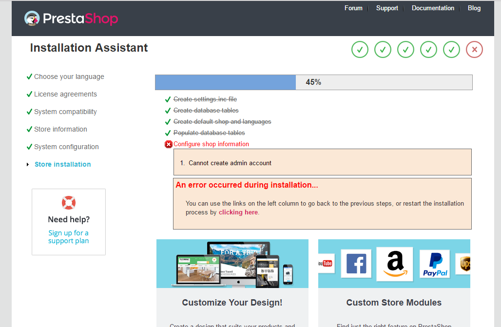

MarcDieters Posted November 5, 2015 Share Posted November 5, 2015 (edited) Hi, I'm new to prestashop. I want to setup Presta on a Server 2012 R2 box. Here are the steps I took: - Installed IIS, PHP (used the Web Platform downloader) and MySQL. - Created a schema, a user and provided the user full permissions on the schema. - Created a website and copied the downloaded Presta files to the correct location. - Browsed to the website and followed the steps. At 12%, when the database is created the attached error occurs. SQL error on query All parts of a PRIMARY KEY must be NOT NULL; if you need NULL in a key, use UNIQUE instead The database is filled with tables though, so it's not a permissions issue I think. The versions I use (all the latest that can be found). - MySQL: 5.7 - PHP 5.6.0 (5.3.28 is also installed). - Presta: 1.6.12. I don't have any experience with PHP / MySQL so I'm really stuck. Can anyone provide some guidance how I can get the site setup ? Thanks. Edited November 5, 2015 by MarcDieters (see edit history) Link to comment Share on other sites More sharing options...

daniboy1969 Posted September 26, 2016 Share Posted September 26, 2016 Hello, I was able to get to this point by changing the dates, now what?!!! Link to comment Share on other sites More sharing options...
