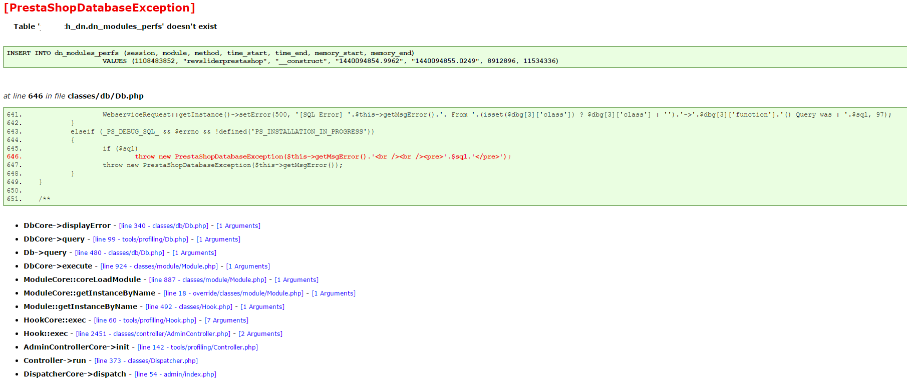

I tried to update to prestashop 1.6.1.0 but many bugs appear.
I restored prestashop 1.6.0.14 and enabled debug mode, this error appear as ps 1.6.1.0
I found revsliderprestashop then uninstalled module but it is always same error.
Please see attachment image.

Hello,
I checked them before postting here.
I don't know which modules created table modules_perfs.
I googled and see this link: http://scm.prestashop.com/rdiff/PrestaShop_v.1.5?csid=fc9b51114196e1612e34acac2ab3d4a05ed9c85b&u&N
But my prestashop is 1.6.0.14 version.
When I try to upgrade to 1.6.1.1 version, that bug disappear but I'm using agilemultiseller module and warehouse theme on ps 1.6.0.14.
Prestashop 1.6.1.1 version, agilemultiseller, warehouse is not stable version.
Hello,
I found this bug.
This error said that we need to create table modules_perfs to save cache modules.
Please go to phpmyadmin and insert this code:
CREATE TABLE IF NOT EXISTS `ps_modules_perfs` (
  `id_modules_perfs` int(11) unsigned NOT NULL,
  `session` int(11) unsigned NOT NULL,
  `module` varchar(62) NOT NULL,
  `method` varchar(126) NOT NULL,
  `time_start` double unsigned NOT NULL,
  `time_end` double unsigned NOT NULL,
  `memory_start` int(10) unsigned NOT NULL,
  `memory_end` int(10) unsigned NOT NULL
) ENGINE=InnoDB AUTO_INCREMENT=419 DEFAULT CHARSET=utf8;
ALTER TABLE `ps_modules_perfs`
  ADD PRIMARY KEY (`id_modules_perfs`),
  ADD KEY `session` (`session`);
  MODIFY `id_modules_perfs` int(11) unsigned NOT NULL AUTO_INCREMENT,AUTO_INCREMENT=419;
Edited by codochi (see edit history)
