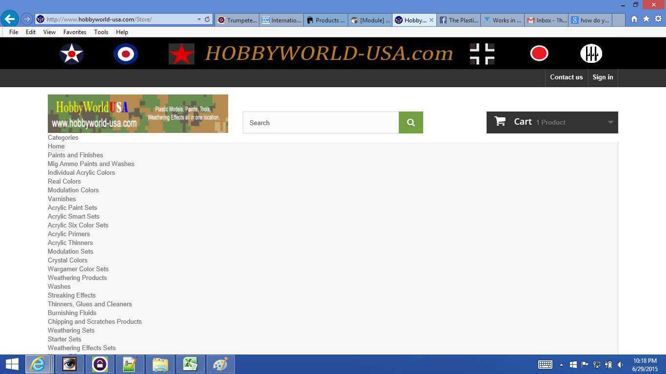

mcbole62 Posted June 30, 2015 Share Posted June 30, 2015 Hello, I made an attempt at adding a background image to my BODY statement in Global.CSS. It didn't work, so I removed the line I had entered. When I went back to view my store, the horizontal menu bar wasn't there any more, instead it was now a vertically aligned menu bar. Can anyone tell me how I can get it to return to working as a Horizontal Menu Bar. I've tried all the tricks I could think off including copying over a brand new default-boostrap folder with clean files, but still no luck. To see for your self what the store looks like now, visit www.hobbyworld-usa.com Thank you. Link to comment Share on other sites More sharing options...

Dh42 Posted June 30, 2015 Share Posted June 30, 2015 Actually it looks like the menu CSS is not loading. is this file on your server, default-bootstrap/css/modules/blocktopmenu/css/superfish-modified.css Link to comment Share on other sites More sharing options...
Dh42 Posted June 30, 2015 Share Posted June 30, 2015 If it is, try reseting the top menu, it does not seem to be loading that file. Link to comment Share on other sites More sharing options...
mcbole62 Posted June 30, 2015 Author Share Posted June 30, 2015 It wasn't, but it is now. Still not working. Link to comment Share on other sites More sharing options...
mcbole62 Posted June 30, 2015 Author Share Posted June 30, 2015 Where do I reset it ? Link to comment Share on other sites More sharing options...
Dh42 Posted June 30, 2015 Share Posted June 30, 2015 On the module page next to where you configure it. I would re-upload the module and the the module files to the theme, both the js and css files from it. I think it is missing files is the issue. Link to comment Share on other sites More sharing options...
mcbole62 Posted June 30, 2015 Author Share Posted June 30, 2015 On the Positions page under Modules ? I uploaded the complete MODULE file for the theme. Still nothing. Link to comment Share on other sites More sharing options...
Dh42 Posted June 30, 2015 Share Posted June 30, 2015 On the main module page in the menu on the right http://screencast.com/t/wPmy7zmM The only thing I can think of is that either the css or js files are not on the server. Link to comment Share on other sites More sharing options...
mcbole62 Posted June 30, 2015 Author Share Posted June 30, 2015 That worked ! Thank you thank you thank you !!!! Link to comment Share on other sites More sharing options...
Dh42 Posted June 30, 2015 Share Posted June 30, 2015 Glad it fixed it, it must have gotten unhooked from the header some how. Link to comment Share on other sites More sharing options...
