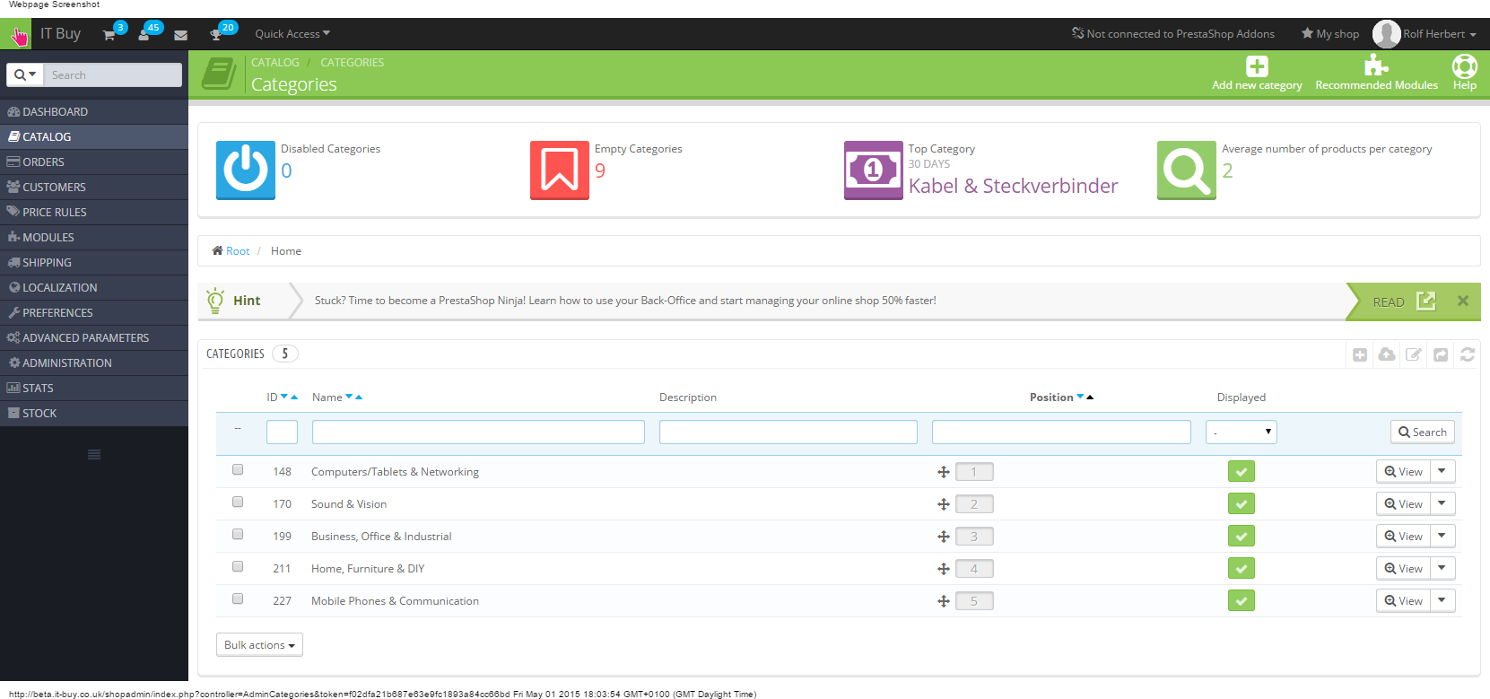

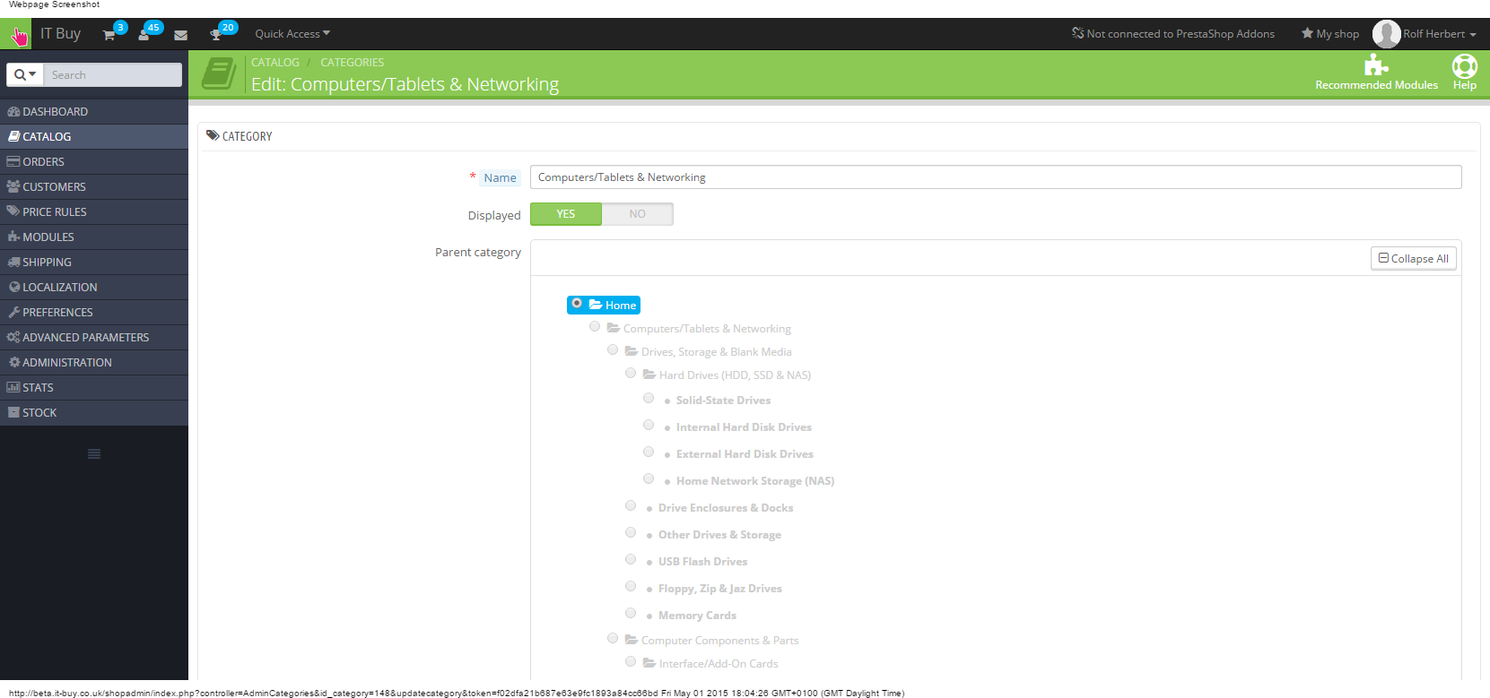

2 - This is probably due to my lack of understanding of how the categories work...it always confuses me, but the default 2 in the category box brings up no products but if I enter the ID of one of my existing categories all is well.
According to the category edit page there is no available HOME cateogry (there was previous to me adding categories) but when I edit a main category it displays as being underneath the home category.
Very confused =)

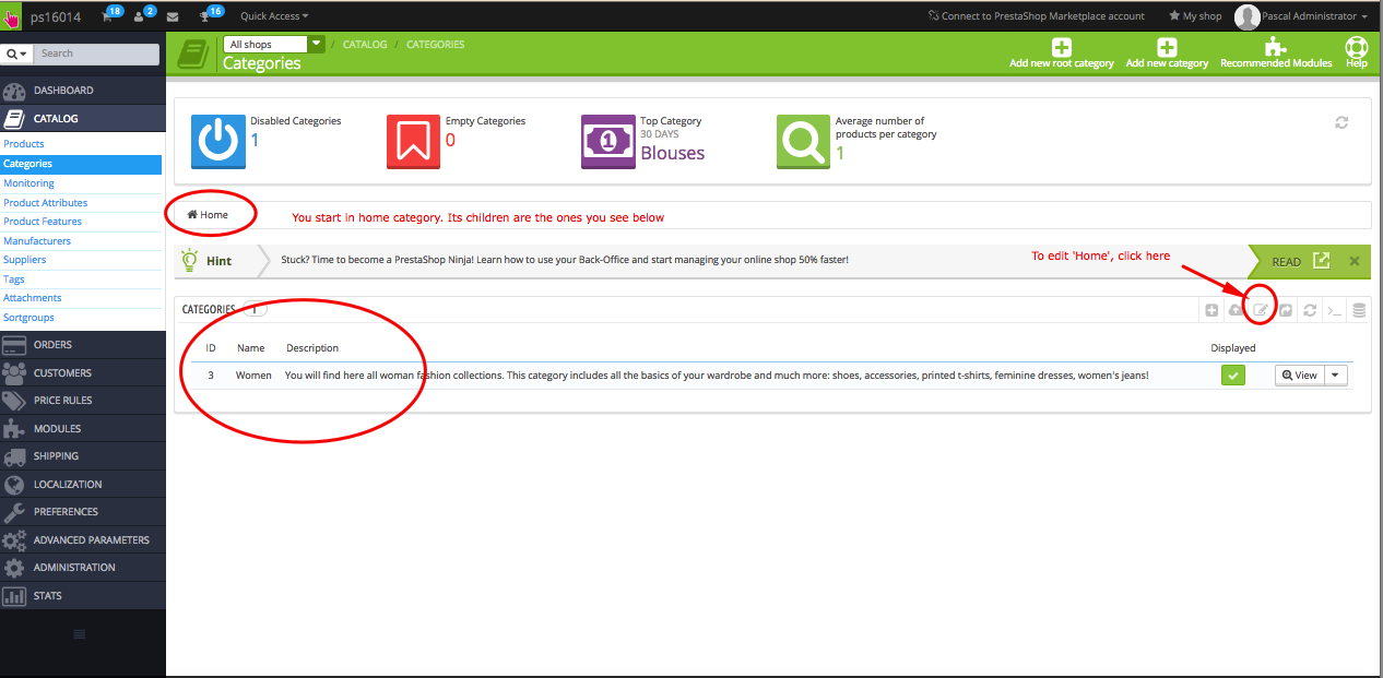

The Home category, is the start category for your shop.

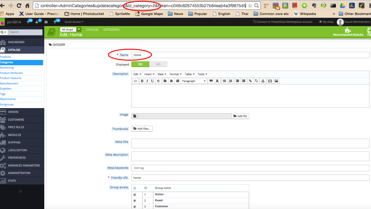

To edit the Home category (for example, if you would like to rename 'Home' or so), click on the little edit icon on the right (see image)
The categories on the start page when editing categories, are the children of the home category, which in turn can have their own children etc. All these categories you will make yourself.
