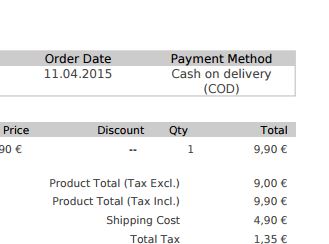

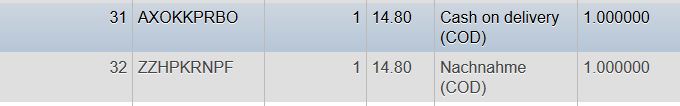

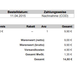

kalua Posted April 11, 2015 Share Posted April 11, 2015 Hey all I have a strange problem and can't find a solution. I'am working PS 1.6.0.11 with the default template. Please take a look at the screenshot below. As you can see the invoice is made in english via the english Frontoffice. Therefor everything's fine except the word "Banküberweisung" below the payment method. Normally it should be "Bank wire" ... Problem No. 1 - i have no idea from where this come from. With the translations in the bank wire module everythings ok. I'am just wondering why it is "Banküberweisung" if I'am in the english FO. Therefor I made a test with the COD (Cash on Delivery) in the FO. First order in english and second order in german. As you can see below everythings fine. Also a check in the database (ps_order_payment) ... everythings fine. But take a look at this ... It doesn't matter if I'am in english in the Front Office, if I make an order, "Banküberweisung" will be written to the database instead of Bank wire. Does somebody know which part of prestashop is responsible for this? Thanks for any help Link to comment Share on other sites More sharing options...

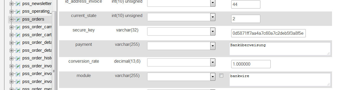

selectshop.at Posted April 12, 2015 Share Posted April 12, 2015 (edited) As I cannot answer in German Forum so I answer here your second question for database: Banküberweisung is written into dabatase but only for the order, , cause your main shop language is German, BUT not for payment (module) row which is always English (software language). If the main language of your shop is Portuguese or English for ex. than into database is written Portuguese translated or English translated. See screen attached. Edited April 12, 2015 by selectshop.at (see edit history) Link to comment Share on other sites More sharing options...

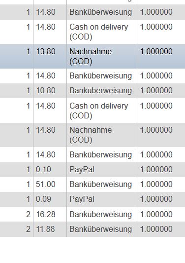

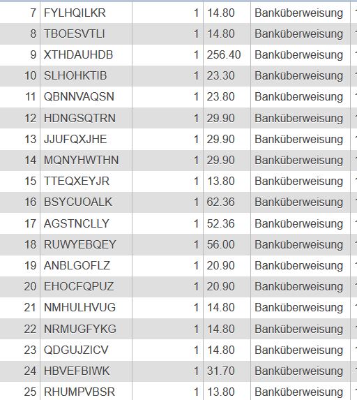

kalua Posted April 12, 2015 Author Share Posted April 12, 2015 Hey Thanks for your reply. So far so clear, but I have also foreign languages in the table row. If a place an order in english languag in FO with Payment "Cash on Delivery (COD) i get this entry also in the database ps_order_payment Take a look at this ... As you can see COD will be written in german and english depends on the actual language in the FO.But with Bank Wire .. i everytime get "Banküberweisung" in the tablerow, it doesn't matter if I'am on english or german. Thats strange!! Isnt it? Link to comment Share on other sites More sharing options...
selectshop.at Posted April 14, 2015 Share Posted April 14, 2015 No, it is not strange. Basically what is written into database is the language your shop is set. If it is set to localization EN than the entry in DB is EN. If it is set to DE, than the entry is DE, if it is set to PT, than the entry is PT. This is independent of the customer language. If you want your invoice printed in customer's language, so there is a fix you can find in the English Forum as well: https://www.prestashop.com/forums/topic/396155-need-to-display-double-currency-and-change-pdf-language/?do=findComment&comment=2011871 Link to comment Share on other sites More sharing options...
