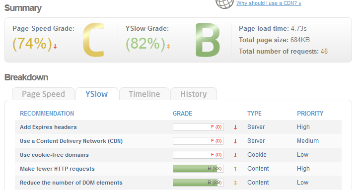

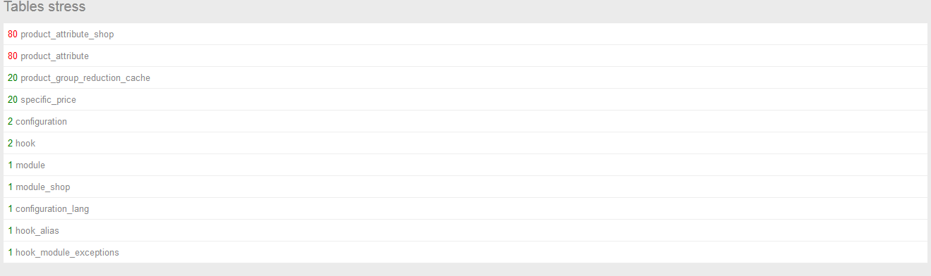

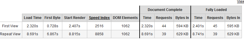

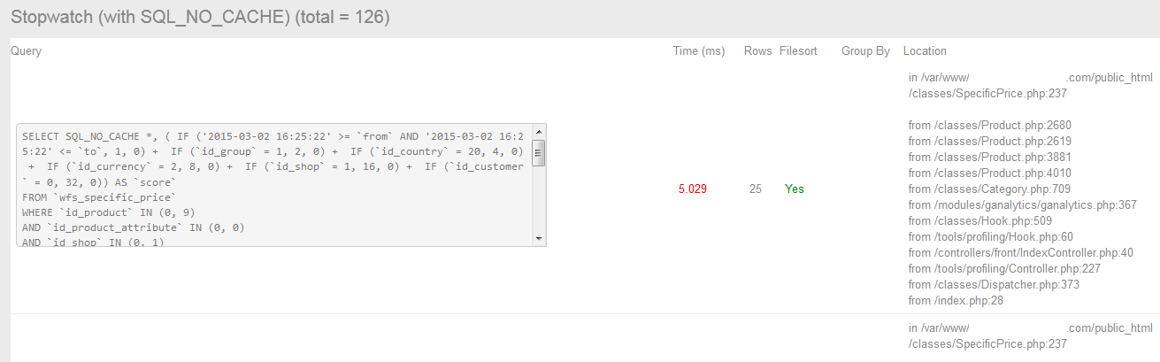

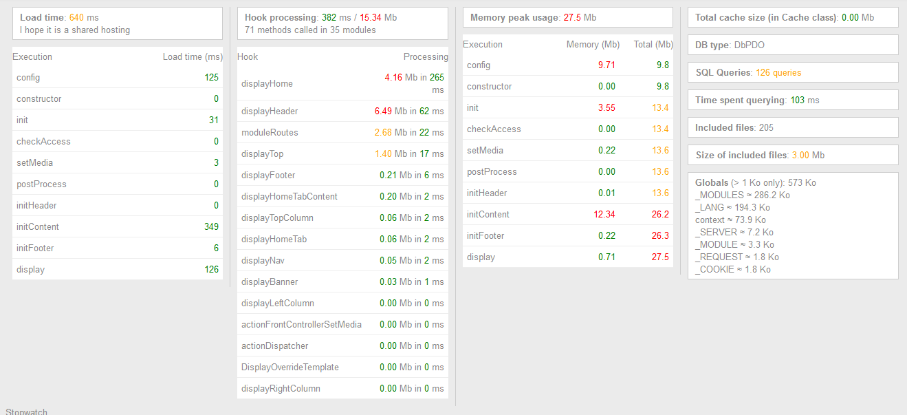

Crowell Posted March 2, 2015 Share Posted March 2, 2015 Hey everyone, I have many problems with the website speed - not only first loading is long but second take double. Some data: 1-6 are debug mode, other 2 are website analysis. I turned off unofficial modules which made website slower for 0,2s I understand that these are the biggest issue: Add Expires headers F (0) 26% Server High Use a Content Delivery Network (CDN) F (0) 13% Server Medium Use cookie-free domains However I don't know how to change it, and would like to ask you will it really help? Or is it because of my shared hosting https://en.unoeuro.com/products.php - bronze one? Hope that anyone will have time and willing to take a look, I spend many days on optimizing it but I have to go below 3s. Link to comment Share on other sites More sharing options...
JPresta.com Posted March 2, 2015 Share Posted March 2, 2015 Well, your profiling results are not that bad, 640ms is good in terms of server response time (page generation) Next you really should add expires headers, this one is important: enable apache optimization in Performances tab. Link to comment Share on other sites More sharing options...
