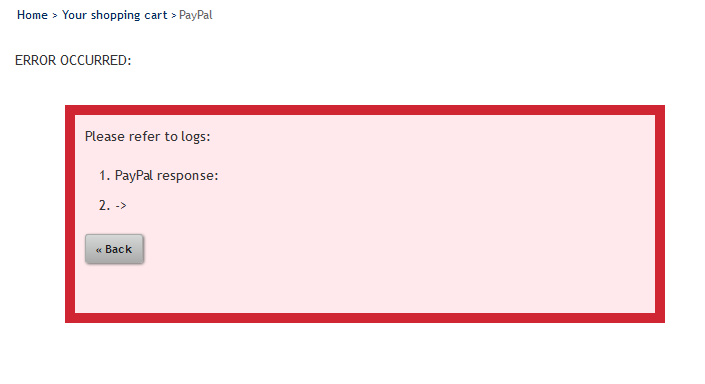

albertalbert Posted February 2, 2015 Share Posted February 2, 2015 We're currently on Prestahop 1.5.2 using the included Paypal module, version 3.2.5. Suddently this module has stopped working (since a couple weeks ago). Users can go normally thorugh the checkout process, logging in, selecting shipping address, etc. In the step where they can select the payment method (we have CC and Paypal), if they select Paypal they get the message that the attached screenshot shows: Error occurred:Please refer to logs: PayPal response: -> That's all. The logs don't show anything (PHP logs nor Prestashop logs). Whenever a user gets that error we get an email that says: Error reporting from your PayPalAPI module A client has encountered a problem with the module PayPalAPI, see the report: PayPal response: -> The CC module still works fine, we've tested it. We haven't changed ANYTHING in the whole website for months, so we have no idea of what's causing this and of course the error logs don't help much either. The Paypal module info is correct (same its always been without issues). Can someone help us figure this out? Thanks in advance! Link to comment Share on other sites More sharing options...
PrestaHeroes.com Posted February 2, 2015 Share Posted February 2, 2015 We're currently on Prestahop 1.5.2 using the included Paypal module, version 3.2.5. Suddently this module has stopped working (since a couple weeks ago). Users can go normally thorugh the checkout process, logging in, selecting shipping address, etc. In the step where they can select the payment method (we have CC and Paypal), if they select Paypal they get the message that the attached screenshot shows: Error occurred:Please refer to logs: PayPal response: -> That's all. The logs don't show anything (PHP logs nor Prestashop logs). Whenever a user gets that error we get an email that says: Error reporting from your PayPalAPI module A client has encountered a problem with the module PayPalAPI, see the report: PayPal response:-> The CC module still works fine, we've tested it. We haven't changed ANYTHING in the whole website for months, so we have no idea of what's causing this and of course the error logs don't help much either. The Paypal module info is correct (same its always been without issues). Can someone help us figure this out? Thanks in advance! uninstall/delete your existing paypal module, it is old version and no longer compatible with paypal. then install the latest paypay eu module from addon's. Link to comment Share on other sites More sharing options...
albertalbert Posted February 2, 2015 Author Share Posted February 2, 2015 uninstall/delete your existing paypal module, it is old version and no longer compatible with paypal. then install the latest paypay eu module from addon's. Thank you very much for your quick reply. Should I install the EU one even if I'm in the US? I see there's a USA, Canada & Mexico version too... Link to comment Share on other sites More sharing options...
