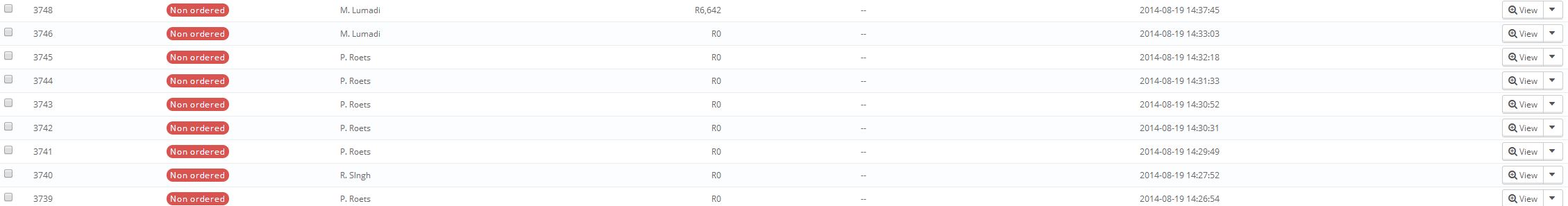

Rebel Tech Posted August 19, 2014 Share Posted August 19, 2014 Hi We are experiencing a lot of, what I assume is caching issues. Customers are complaining about not being able to log in (log in loop) and when adding items to the cart and trying to checkout, the site shows no items in the cart. Please see the picture which shows R0.00 in the shopping cart The one with the amount shows what it should be. If a customer clears his/her cache and cookies then the problem doesn’t happen. I have Cache, APC, PageCache and Cloudflare enabled Thanks Link to comment Share on other sites More sharing options...

JPresta.com Posted August 20, 2014 Share Posted August 20, 2014 Can you reproduce the problem? Because at this time it's working good. If you know how to reproduce you could enable cloudflare back and see if it's still OK. Link to comment Share on other sites More sharing options...
Rebel Tech Posted August 20, 2014 Author Share Posted August 20, 2014 Product still exists. I have turned off PageCache and Cloudflare 3851 Non ordered Customer 1 R469 -- 2014-08-20 10:28:40 View 3850 Non ordered Customer 1 R10,593 -- 2014-08-20 10:28:03 Not sure why it is doing this. Customer says he had to start adding products again after he tried to checkout but it said the cart was empty. Cart ID has changed Link to comment Share on other sites More sharing options...
