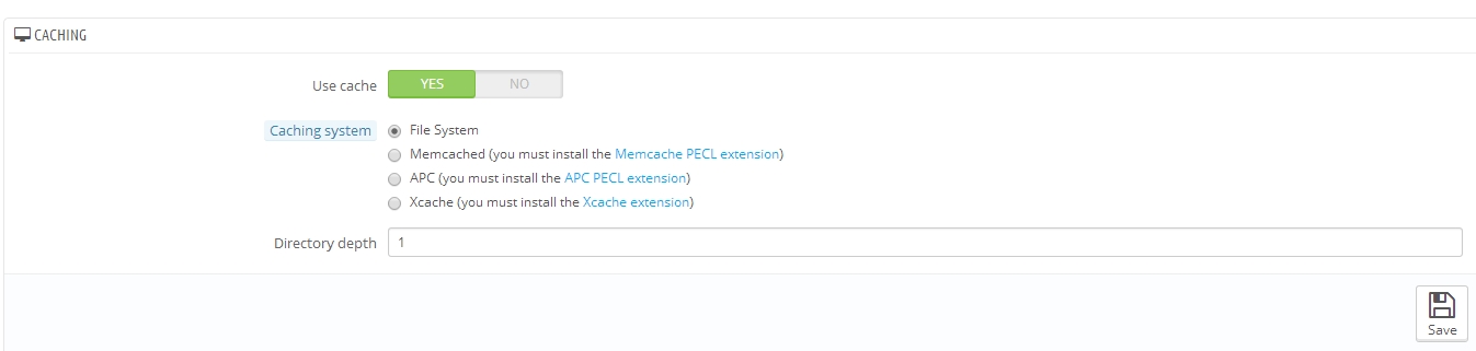

HH Services Limited Posted August 11, 2014 Share Posted August 11, 2014 (edited) After checking with my hosting provider I was told thet they do not support Mcached, Xcache or APC and neither Ps allows it to me, but it allows me to choose the file system... Should I choose it like in the snapshot to improve speed? If so which depth? Thank you.. Edited August 11, 2014 by Anthony DeLa Riviere (see edit history) Link to comment Share on other sites More sharing options...
PrestaHeroes.com Posted August 11, 2014 Share Posted August 11, 2014 I just looked at your shop, for as little that is on front page and the load speed, visitor experience is not so good. your javascript is loading top, that is not good. 1.6 supports javascript load bottom. this is about all I think you could do with this hosting plan to speed it up. re file cache, yes use level 1, maybe try 2-3... the only issue I have ever experienced with file cache is that module install/uninstall can be have oddly. turn off file cache when done working with a module. should be good to go. Link to comment Share on other sites More sharing options...
HH Services Limited Posted August 11, 2014 Author Share Posted August 11, 2014 (edited) thank you!! I will enable cache with directory level 2... (will it go better with 3..?) But how do I move java script load to bottom? Edited August 11, 2014 by Anthony DeLa Riviere (see edit history) Link to comment Share on other sites More sharing options...
PrestaHeroes.com Posted August 11, 2014 Share Posted August 11, 2014 thank you!! I will enable cache with directory level 2... (will it go better with 3..?) But how do I move java script load to bottom? visit any front office page, right click-->view source-->F .js-->you want javascript bottom to load bottom-->bo-->advanced parms-->performacne-->set load java bottom (1.6 only) don't know level of perfect file cache, test it..I think 1 is good Link to comment Share on other sites More sharing options...

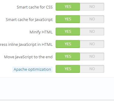

HH Services Limited Posted August 12, 2014 Author Share Posted August 12, 2014 (edited) Thank you for your answer El Patron, but now I am really puzzled because I had already set up advance parameters-performance to "Move JavaScript to the end" like in the snapshot shows: Also, when I see the source of the hema page of the front office the only java I see belongs to the currency part, which is in the header part because the module to display it is hooked to the header... Don´t understand nothing of this, please El Patron, some help over this.. Edited August 12, 2014 by Anthony DeLa Riviere (see edit history) Link to comment Share on other sites More sharing options...
PrestaHeroes.com Posted August 12, 2014 Share Posted August 12, 2014 Thank you for your answer El Patron, but now I am really puzzled because I had already set up advance parameters-performance to "Move JavaScript to the end" like in the snapshot shows: p.jpg Also, when I see the source of the hema page of the front office the only java I see belongs to the currency part, which is in the header part because the module to display it is hooked to the header... j.jpg Don´t understand nothing of this, please El Patron, some help over this.. loading bottom when I looked this time. Maybe I mis-read it the last time. go to the very bottom of source and find .js looking up, there you will see a CCC .js file with all java. 1 Link to comment Share on other sites More sharing options...
