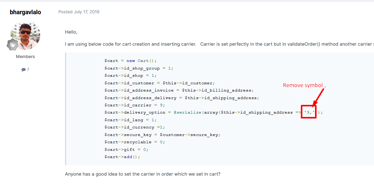

Hello,
I am using below code for cart creation and inserting carrier.   Carrier is set perfectly in the cart but in validateOrder() method another carrier set.
            $cart = new Cart();
            $cart->id_shop_group = 1;
            $cart->id_shop = 1;
            $cart->id_customer = $this->id_customer;
            $cart->id_address_invoice = $this->id_billing_address;
            $cart->id_address_delivery = $this->id_shipping_address;
            $cart->id_carrier = 9;
            $cart->delivery_option = @serialize(array($this->id_shipping_address => '9,'));
            $cart->id_lang = 1;
            $cart->id_currency =1;
            $cart->secure_key = $customer->secure_key;
            $cart->recyclable = 0;
            $cart->gift = 0;
            $cart->add();
Anyone has a good idea to set the carrier in order which we set in cart?

every ID has to be integer (only numbers). Your id is with comma. Remove it.
p.s. I don't use "delivery_option" at all if only one option exist.
