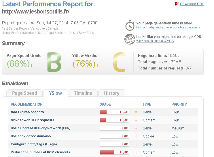

mrduc Posted July 28, 2014 Share Posted July 28, 2014 Hello! I have a problem with Serve static content from a cookieless domain I test my site on http://gtmetrix.com/ and I received "Use a Content Delivery Network (CDN), Use cookie-free domains, Configure entity tags (ETags)" are F(0). I don't know how to fix it. My site is http://www.lesbonsoutils.fr/ and I used CDN service of OVH. Please help me. Thanks! Link to comment Share on other sites More sharing options...
Dh42 Posted July 28, 2014 Share Posted July 28, 2014 The CDN service can strip the cookies usually. Your site has more problems than those listed. Those thing should help a bit, but it still takes 15 seconds for your site to load, I am thinking you might need to upgrade your hosting account. 1 Link to comment Share on other sites More sharing options...
mrduc Posted July 28, 2014 Author Share Posted July 28, 2014 The CDN service can strip the cookies usually. Your site has more problems than those listed. Those thing should help a bit, but it still takes 15 seconds for your site to load, I am thinking you might need to upgrade your hosting account. Thanks for your answer but before I upgrade my hosting account, I want to fix some problems in my question Link to comment Share on other sites More sharing options...
Dh42 Posted July 28, 2014 Share Posted July 28, 2014 Ask your cdn provider if they can strip the cookies. I can tell you that cloudflare, maxcdn, and metacdn cannot strip the cookies. If you merge this pull request, https://github.com/PrestaShop/PrestaShop/pull/1907 you can strip the etags when the htaccess is generated. As for using a content delivery network, you are already using one it sounds like. You can sign up for an account at gtmetrix and add your cdn to the whitelist. Link to comment Share on other sites More sharing options...
mrduc Posted July 28, 2014 Author Share Posted July 28, 2014 Ask your cdn provider if they can strip the cookies. I can tell you that cloudflare, maxcdn, and metacdn cannot strip the cookies. If you merge this pull request, https://github.com/PrestaShop/PrestaShop/pull/1907 you can strip the etags when the htaccess is generated. As for using a content delivery network, you are already using one it sounds like. You can sign up for an account at gtmetrix and add your cdn to the whitelist. Thank you so much. I will ask my cdn provider Link to comment Share on other sites More sharing options...
