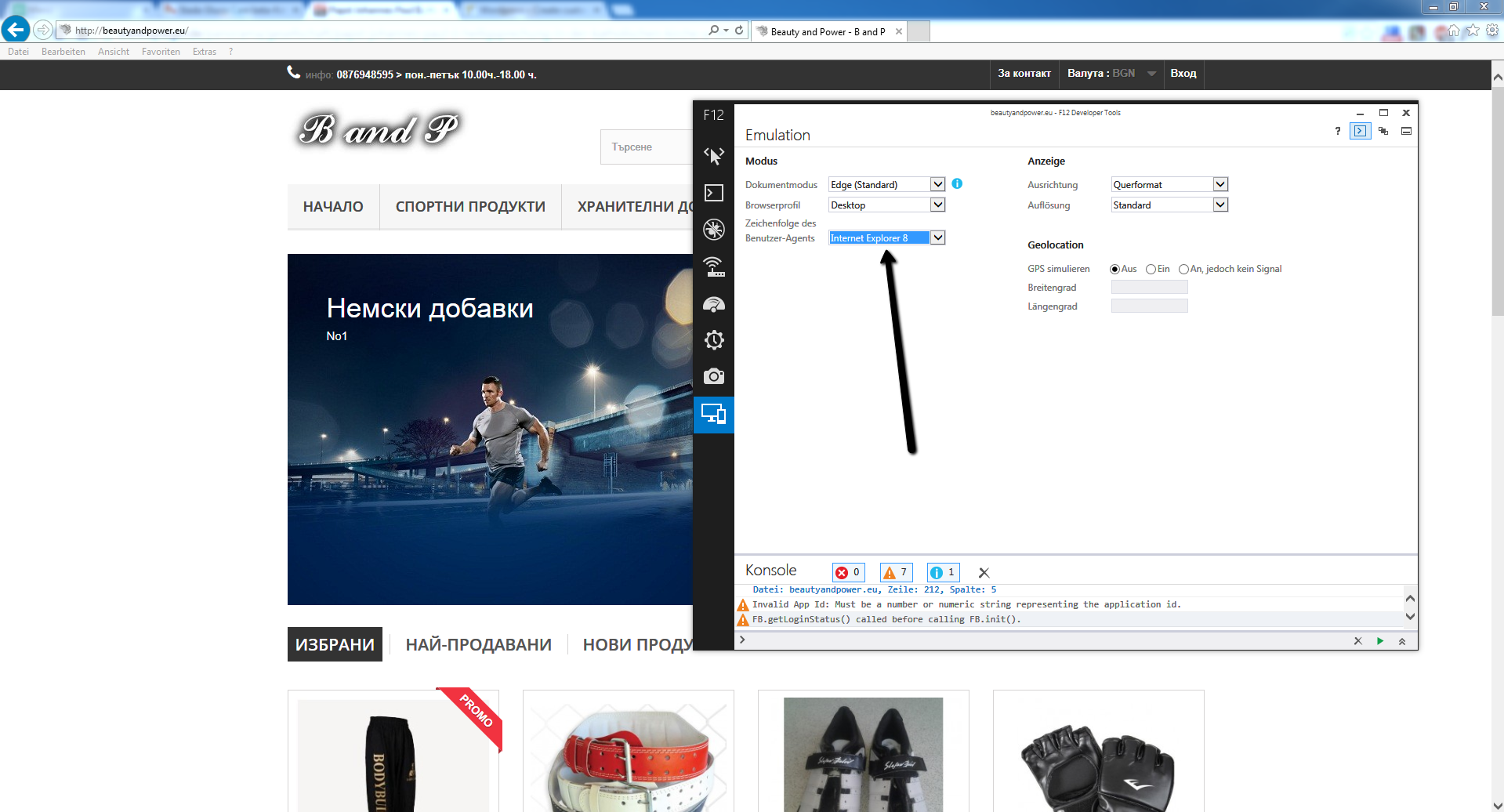

mkkorleone Posted April 26, 2014 Share Posted April 26, 2014 (edited) When i trying to open site with ie i see this. With other browsers not problem. Can you help me test my site. www.beautyandpower.eu Thanks. Edited May 2, 2014 by mkkorleone (see edit history) Link to comment Share on other sites More sharing options...
dioniz Posted April 26, 2014 Share Posted April 26, 2014 I can confirm it doesn't work in ie8. Try to turn of CCC and see if it works Link to comment Share on other sites More sharing options...

dioniz Posted April 26, 2014 Share Posted April 26, 2014 It's strange because in source everything is there Link to comment Share on other sites More sharing options...
prestamax Posted April 26, 2014 Share Posted April 26, 2014 Seems to work now, I can see the site simulating ie8 Link to comment Share on other sites More sharing options...
dioniz Posted April 26, 2014 Share Posted April 26, 2014 It doesn't work in ie8 Link to comment Share on other sites More sharing options...

dioniz Posted April 28, 2014 Share Posted April 28, 2014 Ok i was looking for an answer for this problem and i found out that problem might be in IE8 and cdn, so you shouldn't load your files from cdn but from your server. You have this code in header.tpl: <!--[if IE 8]> <script src="https://oss.maxcdn.com/libs/html5shiv/3.7.0/html5shiv.js"></script> <script src="https://oss.maxcdn.com/libs/respond.js/1.3.0/respond.min.js"></script> <![endif]--> This is not ok. You must download those 2 scripts to your server and make link to them instead of upper link. Link to comment Share on other sites More sharing options...
mkkorleone Posted April 30, 2014 Author Share Posted April 30, 2014 With non-default theme site works . Thank El Patron reports published. Thank Dioniz, but it is very difficult for me to do this 1 Link to comment Share on other sites More sharing options...
mkkorleone Posted May 2, 2014 Author Share Posted May 2, 2014 I have answer for my report.Sadly our latest theme doesn't support any version of IE under 9.Best regards. Link to comment Share on other sites More sharing options...
