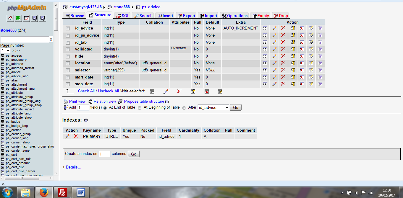

mexicoMATT Posted February 10, 2014 Author Share Posted February 10, 2014 Hi Vekia, Thanks for your advice. Here's what I have done : Firstly) turned off Module updates in Back office. 2nd) I have re-installed the gamification folder with the original PS version for 1.5.4.1. 3rd) Checked the php Database, and tried to create 'hide' column in ps_advice folder , but cannot create as it already exists. Not sure what to do now, is there something in the table that needs to added/deleted? I have attached a screenshot of the 'ps_advice' structure as it stands. Does anything look wrong there? Very much appreciate the help you are offering. Matt. Link to comment Share on other sites More sharing options...
vekia Posted February 10, 2014 Share Posted February 10, 2014 you use ps 1.5.4.1 ? Link to comment Share on other sites More sharing options...
