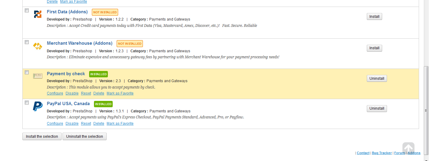

ares Posted December 30, 2013 Share Posted December 30, 2013 I would like to remove modules payment module from the list, definitely.I tried to delete the files: default_country_modules_list.xml modules_list.xml must_have_modules_list.xml Nothing to do, just to update and after some time they are visible again. I can not find where to change.Can anyone help me?? Link to comment Share on other sites More sharing options...

ares Posted December 30, 2013 Author Share Posted December 30, 2013 Grazie per la risposta.In amministrazione > preferenze è già selezionato NO.Continua comunque ad aggiornare la lista moduli.Non ho idea di dove guardare, ho provato tutto.Hai idea di dove si possa intervenire ??Cancellare i moduli dai file nella cartella Config> XML non serve. Che fare ?? Grazie ******************************** Thanks for the reply.In Administration> Preferences is already selected NO.However continues to update the module list.I have no idea where to look, I've tried everything.Any idea where we can intervene?Delete modules from files in the Config folder> XML is not needed. What to do? thanks Link to comment Share on other sites More sharing options...

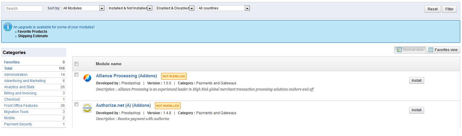

faDdy Posted March 16, 2014 Share Posted March 16, 2014 yeah please i also want this , its really confusing in BO i want to remove the reference for these partner modules , anyone please ? Thank you. Link to comment Share on other sites More sharing options...
vekia Posted March 16, 2014 Share Posted March 16, 2014 controllers/admin/AdminModulesController comment out two lines: //if ($xmlModule->attributes() == 'partner' && $key == 'name') //$this->list_partners_modules[] = (string)$value; in foreach ($module->attributes() as $key => $value) { if ($xmlModule->attributes() == 'native' && $key == 'name') $this->list_natives_modules[] = (string)$value; //if ($xmlModule->attributes() == 'partner' && $key == 'name') //$this->list_partners_modules[] = (string)$value; } Link to comment Share on other sites More sharing options...
faDdy Posted March 16, 2014 Share Posted March 16, 2014 Thanks for your reply Vekia i have made the changes and tried clearing Cache and everything but still i can see those modules in BO. For e.g, Alliance Processing (Addons) Authorize.net (A) (Addons) BluePay (Addons)I could able to remove all these Addons Module. Thank you Link to comment Share on other sites More sharing options...
vekia Posted March 16, 2014 Share Posted March 16, 2014 it's a part of "partner modules" section? i checked on my own and list is empty Link to comment Share on other sites More sharing options...
faDdy Posted March 16, 2014 Share Posted March 16, 2014 yes its exact looks like this : comment out two lines: //if ($xmlModule->attributes() == 'partner' && $key == 'name')//$this->list_partners_modules[] = (string)$value; i don't know why its still appearing. Link to comment Share on other sites More sharing options...

faDdy Posted March 17, 2014 Share Posted March 17, 2014 oh i am sorry i checked again and you are right they are gone but from where these modules are appearing Thank you Link to comment Share on other sites More sharing options...
vekia Posted March 17, 2014 Share Posted March 17, 2014 okay so i see, it appears everywhere instead of page with filter option activated. i've got other solution open this file: ADMIN_DIR/themes/default/template/controllers/modules/list.tpl and change: {foreach from=$modules item=module} <tr> <td> {if (isset($module->id) && $module->id > 0) || !isset($module->type) || $module->type != 'addonsMustHave'} <input type="checkbox" name="modules" value="{$module->name}" {if !isset($module->confirmUninstall) OR empty($module->confirmUninstall)}rel="false"{else}rel="{$module->confirmUninstall|addslashes}"{/if} class="noborder"> {/if} </td> <td><img class="imgm" alt="" src="{if isset($module->image)}{$module->image}{else}../modules/{$module->name}/{$module->logo}{/if}"></td> <td> <div class="moduleDesc" id="anchor{$module->name|ucfirst}" title="{$module->name}"> <h3>{$module->displayName}<span style="display:none">{$module->name}</span> {if isset($module->type) && $module->type == 'addonsMustHave'} <span class="setup must-have">{l s='Must Have'}</span> {else} {if isset($module->id) && $module->id gt 0} <span class="setup{if isset($module->active) && $module->active eq 0} off{/if}">{l s='Installed'}</span> {else} <span class="setup non-install">{l s='Not installed'}</span> {/if} {/if} </h3> <div class="metadata"> {if isset($module->author) && !empty($module->author)} <dl class=""> <dt>{l s='Developed by'} :</dt> <dd>{$module->author|truncate:20:'...'}</dd>| </dl> {/if} <dl class=""> <dt>{l s='Version'} :</dt> <dd>{$module->version} {if isset($module->version_addons)}({l s='Update'} {$module->version_addons} {l s='Available on PrestaShop Addons'}){/if} </dd>| </dl> <dl class=""> <dt>{l s='Category'} :</dt> <dd>{$module->categoryName}</dd> </dl> </div> <p class="desc">{if isset($module->description) && $module->description ne ''}{l s='Description'} : {$module->description}{else} {/if}</p> {if isset($module->message) && (empty($module->name) === false) && (!isset($module->type) || ($module->type != 'addonsMustHave' || $module->type !== 'addonsNative'))}<div class="conf">{$module->message}</div>{/if} <div class="row-actions-module"> {if !isset($module->not_on_disk)} {$module->optionsHtml} {if isset($module->preferences) && $module->preferences['favorite'] == 1} <a class="action_module action_unfavorite toggle_favorite" data-module="{$module->name}" data-value="0" href="#">{l s='Remove from Favorites'}</a> <a class="action_module action_favorite toggle_favorite" data-module="{$module->name}" data-value="1" href="#" style="display: none;">{l s='Mark as Favorite'}</a> {else} <a class="action_module action_unfavorite toggle_favorite" data-module="{$module->name}" data-value="0" href="#" style="display: none;">{l s='Remove from Favorites'}</a> <a class="action_module action_favorite toggle_favorite" data-module="{$module->name}" data-value="1" href="#">{l s='Mark as Favorite'}</a> {/if} {else} {/if} </div> </div> </td> <td> <ul id="list-action-button"> {if isset($module->type) && $module->type == 'addonsMustHave'} <li> <a href="{$module->addons_buy_url}" target="_blank" class="button updated"><span><img src="../img/admin/cart_addons.png"> {if isset($module->id_currency) && isset($module->price)}{displayPrice price=$module->price currency=$module->id_currency}{/if}</span></a> </li> {else} {if isset($module->version_addons) && $module->version_addons} <li><a href="{$module->options.update_url}" class="button updated"><span>{l s='Update it!'}</span></a></li> {/if} <li> <a {if isset($module->id) && $module->id gt 0 && !empty($module->options.uninstall_onclick)}onclick="{$module->options.uninstall_onclick}"{/if} href="{if isset($module->id) && $module->id gt 0}{$module->options.uninstall_url}{else}{$module->options.install_url}{/if}" class="button installed"> <span>{if isset($module->id) && $module->id gt 0}{l s='Uninstall'}{else}{l s='Install'}{/if}</span> </a> </li> {/if} </ul> </td> </tr> {/foreach} to: {foreach from=$modules item=module} {if $module->type!="addonsNative" && $module->type!="addonsMustHave"} <tr> <td> {if (isset($module->id) && $module->id > 0) || !isset($module->type) || $module->type != 'addonsMustHave'} <input type="checkbox" name="modules" value="{$module->name}" {if !isset($module->confirmUninstall) OR empty($module->confirmUninstall)}rel="false"{else}rel="{$module->confirmUninstall|addslashes}"{/if} class="noborder"> {/if} </td> <td><img class="imgm" alt="" src="{if isset($module->image)}{$module->image}{else}../modules/{$module->name}/{$module->logo}{/if}"></td> <td> <div class="moduleDesc" id="anchor{$module->name|ucfirst}" title="{$module->name}"> <h3>{$module->displayName}<span style="display:none">{$module->name}</span> {if isset($module->type) && $module->type == 'addonsMustHave'} <span class="setup must-have">{l s='Must Have'}</span> {else} {if isset($module->id) && $module->id gt 0} <span class="setup{if isset($module->active) && $module->active eq 0} off{/if}">{l s='Installed'}</span> {else} <span class="setup non-install">{l s='Not installed'}</span> {/if} {/if} </h3> <div class="metadata"> {if isset($module->author) && !empty($module->author)} <dl class=""> <dt>{l s='Developed by'} :</dt> <dd>{$module->author|truncate:20:'...'}</dd>| </dl> {/if} <dl class=""> <dt>{l s='Version'} :</dt> <dd>{$module->version} {if isset($module->version_addons)}({l s='Update'} {$module->version_addons} {l s='Available on PrestaShop Addons'}){/if} </dd>| </dl> <dl class=""> <dt>{l s='Category'} :</dt> <dd>{$module->categoryName}</dd> </dl> </div> <p class="desc">{if isset($module->description) && $module->description ne ''}{l s='Description'} : {$module->description}{else} {/if}</p> {if isset($module->message) && (empty($module->name) === false) && (!isset($module->type) || ($module->type != 'addonsMustHave' || $module->type !== 'addonsNative'))}<div class="conf">{$module->message}</div>{/if} <div class="row-actions-module"> {if !isset($module->not_on_disk)} {$module->optionsHtml} {if isset($module->preferences) && $module->preferences['favorite'] == 1} <a class="action_module action_unfavorite toggle_favorite" data-module="{$module->name}" data-value="0" href="#">{l s='Remove from Favorites'}</a> <a class="action_module action_favorite toggle_favorite" data-module="{$module->name}" data-value="1" href="#" style="display: none;">{l s='Mark as Favorite'}</a> {else} <a class="action_module action_unfavorite toggle_favorite" data-module="{$module->name}" data-value="0" href="#" style="display: none;">{l s='Remove from Favorites'}</a> <a class="action_module action_favorite toggle_favorite" data-module="{$module->name}" data-value="1" href="#">{l s='Mark as Favorite'}</a> {/if} {else} {/if} </div> </div> </td> <td> <ul id="list-action-button"> {if isset($module->type) && $module->type == 'addonsMustHave'} <li> <a href="{$module->addons_buy_url}" target="_blank" class="button updated"><span><img src="../img/admin/cart_addons.png"> {if isset($module->id_currency) && isset($module->price)}{displayPrice price=$module->price currency=$module->id_currency}{/if}</span></a> </li> {else} {if isset($module->version_addons) && $module->version_addons} <li><a href="{$module->options.update_url}" class="button updated"><span>{l s='Update it!'}</span></a></li> {/if} <li> <a {if isset($module->id) && $module->id gt 0 && !empty($module->options.uninstall_onclick)}onclick="{$module->options.uninstall_onclick}"{/if} href="{if isset($module->id) && $module->id gt 0}{$module->options.uninstall_url}{else}{$module->options.install_url}{/if}" class="button installed"> <span>{if isset($module->id) && $module->id gt 0}{l s='Uninstall'}{else}{l s='Install'}{/if}</span> </a> </li> {/if} </ul> </td> </tr> {/if} {/foreach} 1 Link to comment Share on other sites More sharing options...
