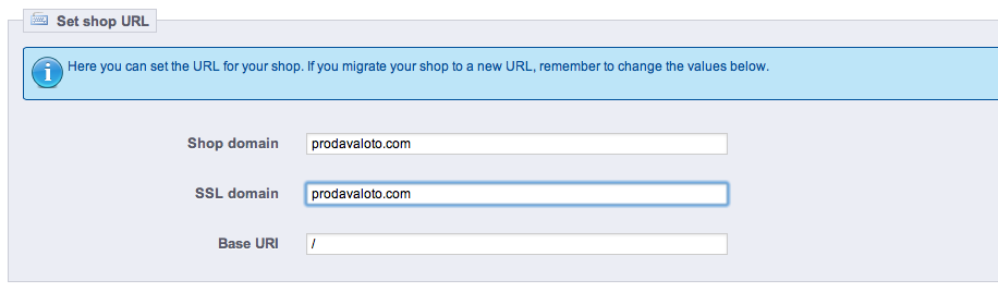

PrestaHeroes.com Posted December 11, 2013 Share Posted December 11, 2013 back office-->preferences-->seo & urls edit 'Page' index remove friendly URL (requires mod_rewrite and friendly urls to be active) I have seen many similar topics in internet, but it seems to be not the real cause of my problem. The domain name is clear without any /index.php behind Screen Shot 2013-12-11 at 10.09.26 AM.png Link to comment Share on other sites More sharing options...
IGNITER Posted December 11, 2013 Author Share Posted December 11, 2013 Friendly URL is not enabled by default. After deletion index page by default positioned on 4-th position nothing changed the picture. I will try to inspect the apache config for any case, but i doubt is that, because I have already running another older prestashop with similar config without any issues. I even temporary removed the .htaccess file in the root dir if for some reason is messing with my website and no luck. Link to comment Share on other sites More sharing options...
