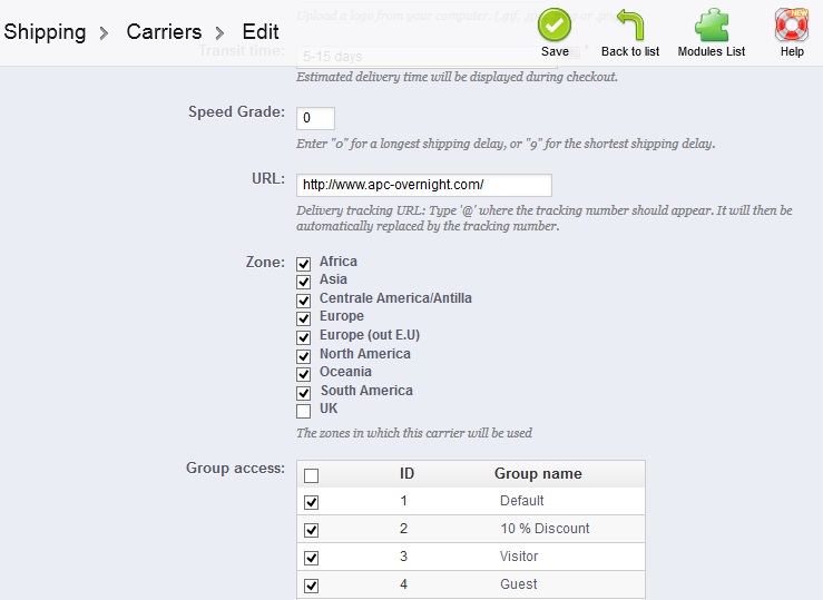

Ray UK Posted December 22, 2013 Share Posted December 22, 2013 (edited) Exactly as Pascal described. I have used the default zones that came with PS 1.5.4.1 Here is my international shipping option and it works fine. Edited December 22, 2013 by MerseyRay (see edit history) Link to comment Share on other sites More sharing options...
