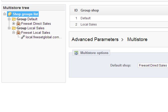

Sharak Posted July 30, 2013 Share Posted July 30, 2013 What version of presta? How did you make your second store? Take the screenshot of store tree (all expanded) in Multistore tab in your admin. Link to comment Share on other sites More sharing options...
freeset Posted August 9, 2013 Share Posted August 9, 2013 Reubsnz is using Prestashop version is 1.5.4.1 (I'm working on the same project) The second store was originally made in Prestashop as another shop in the same group. After all the problems being experienced with the warehouse cross-talk we tried moving the shop to a different shop group. Same things happen.... Link to comment Share on other sites More sharing options...
