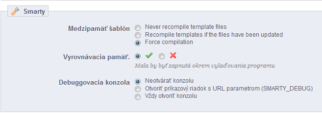

PrestaHeroes.com Posted May 22, 2013 Share Posted May 22, 2013 what happens when you turn 'on' smarty force compile? Link to comment Share on other sites More sharing options...
VitruvianMan Posted May 22, 2013 Author Share Posted May 22, 2013 Nothing. I tried to turn it off, then on, with or without turned on cache. You can see actual configuration in attached file. Thanks Link to comment Share on other sites More sharing options...
