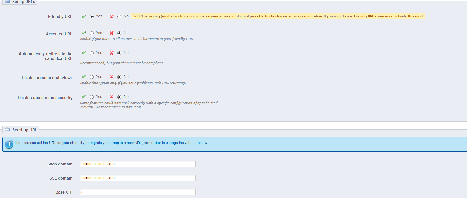

closeupman Posted April 6, 2013 Author Share Posted April 6, 2013 (edited) Thanks for your reply. Checked your thread, and checked my params, and looks like I have what you have...so no go See attached. edit: You are currently connected under the following domain name: sitinuriatistudio.com This is different from the main shop domain name set in the "Multistore" page under the "Advanced Parameters" menu: www.sitinuriatistudio.com Click here if you want to modify your main shop's domain name. Edited April 6, 2013 by closeupman (see edit history) Link to comment Share on other sites More sharing options...

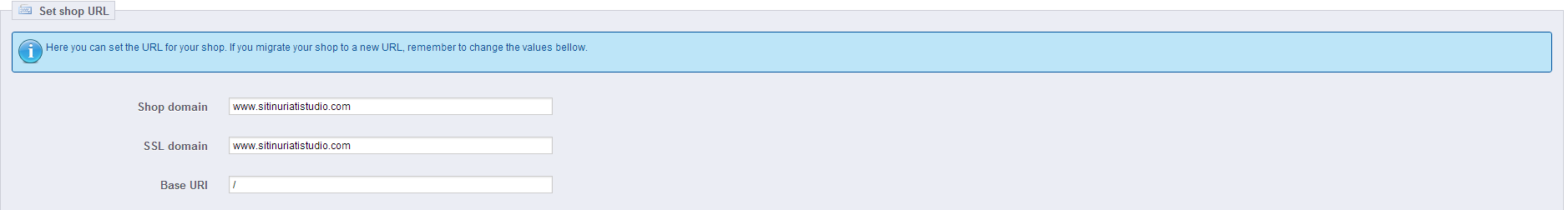

closeupman Posted April 6, 2013 Author Share Posted April 6, 2013 (edited) actually, got it to work now. weird though, definitely not for the faint of heart! see attached. (I know prestashops in France, but can't they do a spell check: below, not bellow ) thanks for your info. got me to thinking and to fix it. now can add to cart! edit: also, now user can login!! Edited April 6, 2013 by closeupman (see edit history) Link to comment Share on other sites More sharing options...
