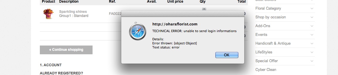

adrianang Posted December 20, 2012 Share Posted December 20, 2012 Hi, today I run into a problem. I created an account for myself and when I tried to login, it gave me an error. Attached is the screenshot. Can someone please help? Link to comment Share on other sites More sharing options...

adrianang Posted December 21, 2012 Author Share Posted December 21, 2012 Hi Valerie, My shop is set up as oharaflorist.com and without the www. When I go into subdomains, I do see the www and it won't allow me to delete it. You can go to oharaflorist.com and on the top, there's a LOGIN. You can try using "[email protected]" and password "123456789" (without the quote, of course) From the top following LOGIN, you'll go to /authentication and then blank page If you add any item into shopping cart, check out, and click on the bottom LOGIN, it pops out a window on the error as posted earlier. Link to comment Share on other sites More sharing options...
adrianang Posted January 21, 2013 Author Share Posted January 21, 2013 Hi. Anyone? I have changed the domain redirect to www.oharaflorist.com instead of using oharaflorist.com and then I am still getting the same error when I tried to log in. TECHNICAL ERROR: unable to send login informations Details: Error thrown: [object Object] Text status: error You can try to login using "[email protected]" and password "123456789" Link to comment Share on other sites More sharing options...
adrianang Posted January 21, 2013 Author Share Posted January 21, 2013 I have tried turn on and off the friendly URL feature as well. ANYONE? Please help! My customers can't log in! Link to comment Share on other sites More sharing options...

PrestaHeroes.com Posted January 22, 2013 Share Posted January 22, 2013 ok, I now have the error when authentication Fatal error: Cannot redeclare class CompareProductCore in /home/oharaflo/public_html/override/classes/CompareProduct.php on line 0 It would appear that you have loaded a module that installed a class override in override/classes/CompareProduct.php you should uninstall this module (if that is what created it), check that override/classes/CompareProduct.php (make sure module deleted the class override) and if not then delete it (back it up first). Honestly had you just hired someone to start off, cost you like 20 euros...this would have been fixed long ago Link to comment Share on other sites More sharing options...
adrianang Posted January 22, 2013 Author Share Posted January 22, 2013 ok, I now have the error when authentication Fatal error: Cannot redeclare class CompareProductCore in /home/oharaflo/public_html/override/classes/CompareProduct.php on line 0 It would appear that you have loaded a module that installed a class override in override/classes/CompareProduct.php you should uninstall this module (if that is what created it), check that override/classes/CompareProduct.php (make sure module deleted the class override) and if not then delete it (back it up first). Honestly had you just hired someone to start off, cost you like 20 euros...this would have been fixed long ago I have checked and I don't see any module that I have installed that has the compare products. Anyway, I am deleting the CompareProduct.php and let's see how it goes. The history of the site is long. In summary, I wasn't the person who did it. The person who helped the site owner left and not contactable, and so the site owner came to me. As a friend, I am helping him out. Link to comment Share on other sites More sharing options...
PrestaHeroes.com Posted January 22, 2013 Share Posted January 22, 2013 I can log in now. If at all possible you need to find out how this override was put in there...removing it make cause that process to fail...think of removing it as nothing more than a test...but not final solution... Link to comment Share on other sites More sharing options...
