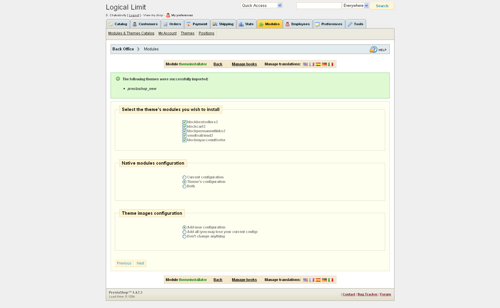

logicallimit Posted April 26, 2012 Share Posted April 26, 2012 I am trying to install the New standard theme PrestaShop 1.5 in my local development environment based on WAMT server. It's a completely new setup with prestashop 1.4.7. When I import this theme (freshly downloaded from prestashop website) in my prestashop installation, not all modules are shown. Snapshot attached. blocktopmenu, blockcontact and some other are not shown. It's absolutely fresh installation on my local machine. Can somebody put some light, what is going wrong and where? Link to comment Share on other sites More sharing options...

logicallimit Posted April 26, 2012 Author Share Posted April 26, 2012 did you try to check the box "add all" instead of "add new" ? I suppose you are talking about the option under "Theme images configuration". That configuration is for image settings. As much as I know, it won't affect the respective modules showing up on the page. Actually all the new modules in this theme should show up on this page. If I consider the Config.xml in the zip file of theme, following is some snapshot of the node entries. And all these modules should show up in this page. <module action="install" name="blocktopmenu"/> <module action="install" name="blocksharefb"/> <module action="install" name="blockcontactinfos"/> <module action="install" name="blockcontact"/> <module action="install" name="blockbestsellers2"/> <module action="install" name="blockcart2"/> <module action="install" name="blockpermanentlinks2"/> <module action="install" name="sendtoafriend2"/> <module action="install" name="blockmyaccountfooter"/> <module action="install" name="blocksocial"/> <module action="install" name="blockreinsurance"/> Link to comment Share on other sites More sharing options...

logicallimit Posted April 26, 2012 Author Share Posted April 26, 2012 I have the same problem. And it's even more strange coz, before I installed prestashop 1.5 template, and mine template made on it, without any problems and now I have the same issue as logicallimit shown. Absolutely. Same with me. It was working till yesterday in my local environment. Today I tried to play with renaming module folders and then correspondingly in Config.xml. And it didn't work somehow. So to start afresh, I completely uninstalled and reinstalled WAMT and then installed prestashop and configured it. Tried to import that theme and whewwwwww.... it never showed me all the modules thereafter. It's over my head. If you get some solution, please do share. Link to comment Share on other sites More sharing options...

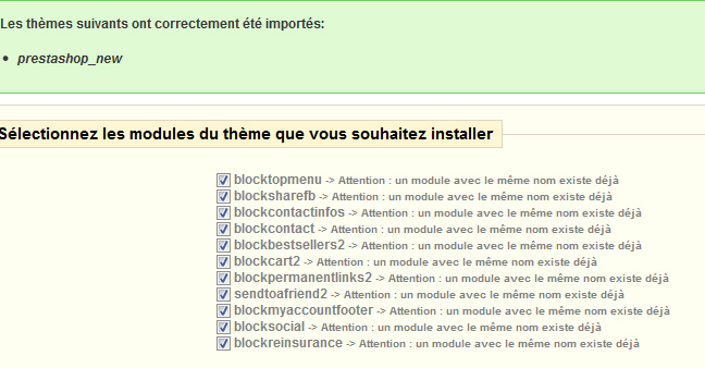

PF22 Posted May 24, 2012 Share Posted May 24, 2012 (edited) I am installing it again, and I have once again a warning that I will install new modules that already exist (image attached)... I don't know what to do with that. Edited May 24, 2012 by Pat_07 (see edit history) Link to comment Share on other sites More sharing options...
Kamel Boukhateb Posted May 25, 2012 Share Posted May 25, 2012 Hello, It is not an error message. I guess you already tried to install this theme so its normal to see this message. It shouldn't be a problem. Link to comment Share on other sites More sharing options...
