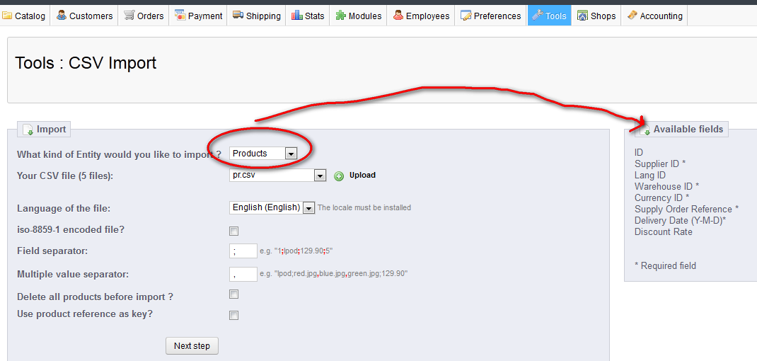

In Prestashop 1.5.0.3
Selecting the import section (What kind of Entity would you like to import ?) for instance selecting products does not effecting the 'Available fields' field.
And also, selecting categories,suppliers,etc. most of them, does not effect the field.

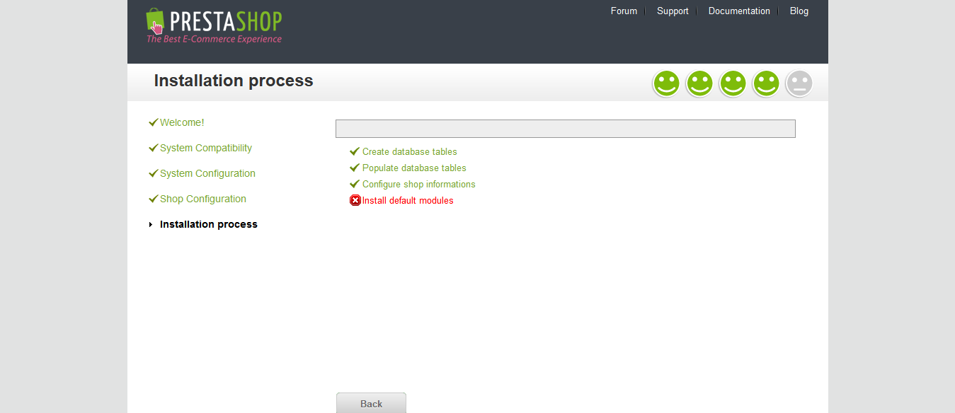

The beta didn't work quite well for me either, it stopped at the last step under installation: installing extra modules. The first time, I could access the admin, but when trying to do a reinstallation, it wouldn't work at all. The SVN version however works fine.
Any error displayed when it stopped installing? When you tried to do a reinstallation, what happened?
Nope, it just went stall. No messages.

Hello Blanco,
do you have Firefox + Firebug ? If so, can you open Firebug during installation, go on "console" tab and give me the answer of the last ajax query ?
Regards
I managed to install by changing the default upload max filesize (default from wamp was 2M, now is 100).

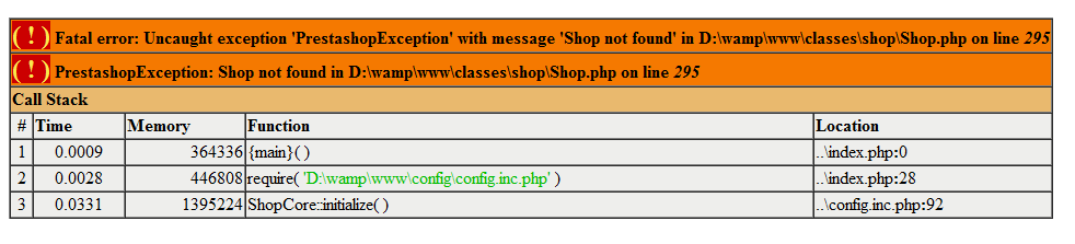

Now i have another problem. After install, i get this error from attach.
I get the error after i set to display errors from config/

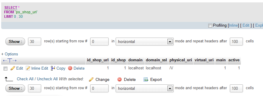

@Dimaer : can you test a new installation with the last SVN version and tell me if everything is now fine with images ?
@Blanco : thank you for screenshot, can you tell me with which type of server you work ? Wampserver ? LAMP ? EasyPHP ? IIS ?
Can you give me too the URL of your PrestaShop ? I don't need the domain, just the path. For example if your PrestaShop is in http://localhost/prestashop/ just give me /prestashop/ (with / or with \ if you have backslashes).
