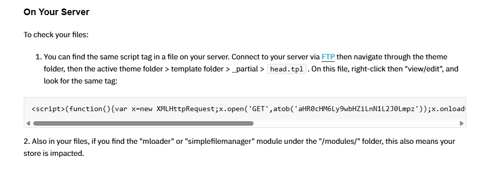

JBW Posted yesterday at 03:08 PM Share Posted yesterday at 03:08 PM Today myself and some customers recevied an email with Prestashop security alert. https://help-center.prestashop.com/hc/en-us/articles/33259937046034-Security-Alert-Recommended-Check-of-Your-Stores?utm_campaign=26061922-Security&utm_medium=email&_hsmi=403312940&utm_content=403312940&utm_source=hs_email It contains no background information regarding the vulnerability. I my opinion it's not enough to check the mentioned file. As soon a attacker can change this template file, they would have full access to the store/database and can read and manipulate the shop in any way they want. So wondering if anybody has more information regarding this alert and why it was send now (as similar skimming attacks are around for years already using several known vulnerabilities in the past) 1 Link to comment Share on other sites More sharing options...
Prestashop Addict Posted yesterday at 03:29 PM Share Posted yesterday at 03:29 PM As the hacker change a template file, the origin is a security hole in module, or ftp/sftp/ssh credentials stolen, not Prestashop core. Link to comment Share on other sites More sharing options...
JBW Posted yesterday at 03:32 PM Author Share Posted yesterday at 03:32 PM 1 minute ago, Prestashop Addict said: As the hacker change a template file, the origin is a security hole in module, or ftp/sftp/ssh credentials stolen, not Prestashop core Might be anywhere, we have seen holes in core before. But without further insights this security alert is useless as nobody would be able to fix the root cause. Link to comment Share on other sites More sharing options...

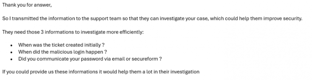

venditdevs Posted 13 hours ago Share Posted 13 hours ago (edited) Clarification on the Security Incident We experienced this exact situation on a webshop we maintain. We have performed a thorough analysis and documented the entire case. Attack Vector and Execution he attacker performed a single, targeted login attempt on the back office, resulting in: 1: A direct, successful hit on the admin URL (which is unique and obfuscated). 2: An immediate successful login via an Addons support account. Once access was gained, the attacker installed a malicious module named "mloader". This module created two overrides in head.tpl and layout-both-columns.tpl, using the exact code described in the recent security mailing from Prestashop. Additionally, communication with the attacker's server was handled via an in.php file placed in the public_html directory. Investigation into the Source We investigated how these specific credentials could have been compromised. Our audit confirmed that the only place these credentials were ever shared was within the Addons Marketplace, specifically for support on a module developed by Prestashop itself. Searching for a potential "Prestashop data breach" reveals reports claiming that over 21 million customer records were leaked from the Prestashop Marketplace: https://www.brinztech.com/breach-alerts/brinztech-alert-post-claims-exposure-of-21-3m-prestashop-customer-records/ https://socradar.io/prestashop-data-panorabanques-new-fraud-services/ Communication with Prestashop We officially opened a case with the Prestashop security team in November 2025, providing all our findings. At that time, they stated they were investigating the potential breach but provided no confirmation. Despite us providing additional information about what happend, we never received a final response or follow-up. Conclusion Since other webshops are now being affected and Prestashop continues to claim the origin of the vulnerability is unknown, I feel obliged to make these findings public. The evidence strongly suggests that a data breach occurred and that credentials shared through the official Marketplace were leaked. Edited 13 hours ago by venditdevs Proper English corrections (see edit history) 3 1 Link to comment Share on other sites More sharing options...
AGuyTryingToCode Posted 13 hours ago Share Posted 13 hours ago @venditdevs Thank you for sharing. I do wish Prestashop would look at their support. Every communication I have ever had with them has been awful (I stopped recommending PS to my clients simply because the support was poor). I guess for now all we can really do is the usual security practices e.g. restrict admin url to specific IPs, add 2FA etc and wait for prestashop to update us all. Link to comment Share on other sites More sharing options...
Mediacom87 Posted 13 hours ago Share Posted 13 hours ago il y a 3 minutes, AGuyTryingToCode a dit : @venditdevs Thank you for sharing. I do wish Prestashop would look at their support. Every communication I have ever had with them has been awful (I stopped recommending PS to my clients simply because the support was poor). I guess for now all we can really do is the usual security practices e.g. restrict admin url to specific IPs, add 2FA etc and wait for prestashop to update us all. I understand better why, every time I provide support for my modules on the platform, users are surprised by my responsiveness and the care I take in addressing their issues. 1 Link to comment Share on other sites More sharing options...

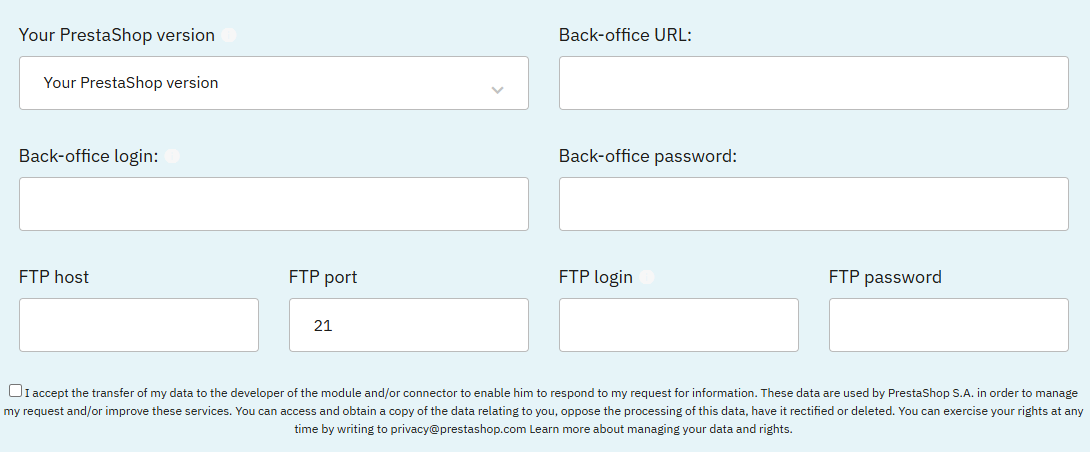

AGuyTryingToCode Posted 13 hours ago Share Posted 13 hours ago (edited) @Mediacom87 as a module developer, I wonder if you could shed any light on what access you personally would have when supporting one of your clients with your modules via the prestashop system? e.g. when a customer opens a support ticket, prestashop requests FTP, login details etc. I never fill these in (I can't due to GDPR laws and would always prefer to make changes myself anyway for security reasons). However, other than what the user fills in on the open a ticket form (see attached), does the developer have access to any other customer details? e.g. can you see the store URL or anything else (assuming the user did not fill in that part of the form)? Edited 13 hours ago by AGuyTryingToCode (see edit history) Link to comment Share on other sites More sharing options...
venditdevs Posted 13 hours ago Share Posted 13 hours ago 3 minutes ago, AGuyTryingToCode said: @Mediacom87 as a module developer, I wonder if you could shed any light on what access you personally would have when supporting one of your clients with your modules via the prestashop system? e.g. when a customer opens a support ticket, prestashop requests FTP, login details etc. I never fill these in (I can't due to GDPR laws and would always prefer to make changes myself anyway for security reasons). However, other than what the user fills in on the open a ticket form (see attached), does the developer have access to any other customer details? e.g. can you see the store URL or anything else (assuming the user did not fill in that part of the form)? If those credentials are provided (only FTP) then yes... The modulemaker can access the parameters file which include the database credentials and with that they can log in to the database. But that's logically only possible with an FTP account with access in the public_html or above folder (of specific deeper in a folder which contains the parameters file). So, customerdata can be visible, and so is the shop URL. 1 Link to comment Share on other sites More sharing options...
AGuyTryingToCode Posted 13 hours ago Share Posted 13 hours ago (edited) @venditdevs Thanks for your reply. so If I am understanding you correctly, your analysis of the 'hack' that you saw was someone using the "Back-office URL", "Back-office login" and "Back-office password" you provided in the form above when submitting a support request for a module that was made by prestashop (not a 3rd party)? p.s. for anyone who is reading this post and is not sure what to do, I would suggest the following as a quick check guide (its not a full guide by any means but should help): 1) Check the files head.tpl and layout-both-columns.tpl (if you know how check your server for any files that have changed recently, if not, ask your host to SSH into the hosting and do this for you) 2) Check your login users and remove any you don't need. 3) Change login details in PS admin 4) Change login URL for PS admin 5) In your admin .htaccess file, add at the top a deny from all but allow your IP: e.g. order deny,allow deny from all allow from 127.0.0.1 (if you have a dynamic IP, you will need to keep changing the 127.0.0.1 to your IP 6) Chanege your mysql databse login details and update your app/config.parameters.php file to match the new details. 7) Change your FTP login details if you provided these. 8) Do a full security audit. Edited 12 hours ago by AGuyTryingToCode (see edit history) Link to comment Share on other sites More sharing options...
Mediacom87 Posted 12 hours ago Share Posted 12 hours ago il y a 21 minutes, AGuyTryingToCode a dit : @Mediacom87 as a module developer, I wonder if you could shed any light on what access you personally would have when supporting one of your clients with your modules via the prestashop system? e.g. when a customer opens a support ticket, prestashop requests FTP, login details etc. I never fill these in (I can't due to GDPR laws and would always prefer to make changes myself anyway for security reasons). However, other than what the user fills in on the open a ticket form (see attached), does the developer have access to any other customer details? e.g. can you see the store URL or anything else (assuming the user did not fill in that part of the form)? Here is the basic stuff we have to make the support: The name of the module, if there is a valid support license, the order number and date of purchase, the module version, the website URL, and support tracking. Sometimes we also have the version of PrestaShop used, but not always. This is very limited when it comes to fixing issues. When a user reports a problem to me, I first run a test on my end using the corresponding version of PrestaShop, and if I can reproduce the bug, I fix it right away. However, it often happens that the problem cannot be reproduced, and that's when I need to access the customer's site directly to analyze the problematic elements. Often, it turns out to be another module. I often do this in less than 24 hours, because we all know how important our users' stores are. I no longer ask for FTP access; I manage with my own tools. So I only ask for back-office access and always advise the customer to create a specific account for me, which will be deleted after my intervention. Otherwise, I recommend using this type of module: Op'art Secure Admin Link: Temporary Back Office Access 1 Link to comment Share on other sites More sharing options...
AGuyTryingToCode Posted 6 hours ago Share Posted 6 hours ago @Mediacom87 Thank you for sharing, much appreciated. So we can see a new update on the post https://help-center.prestashop.com/hc/en-us/articles/33259937046034-Security-Alert-Recommended-Check-of-Your-Stores "Change the passwords for your various accesses (back office, database, FTP, SSH, and don’t forget to update the database access in the PrestaShop config file)." @venditdevs the fact it mentions SSH and FTP would backup what you said since generally these wouldn't be stored (as far as I am aware) in a prestashop store (unless a specific module requested them). I do wish presatshop would just release more information on what's happening. Even just a "we think XYZ may have happened and you should do ABC for now". Even if they then go "oh we think it may just be DEF instead", at least we could take extra precautions etc Link to comment Share on other sites More sharing options...
