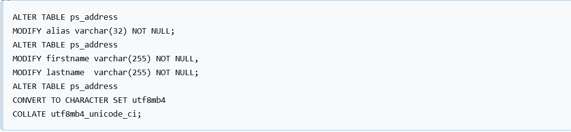

I then tried to add an address to the customer from the backoffice, but that also failed. That made me think this has to be a database problem.
I compared the schemas for ps_address and there were indeed differences. After running the following sql statements to fix the discrepancies, I was able to add addresses using the backoffice:

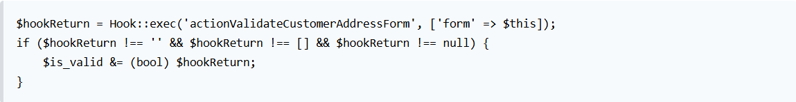

Next up was this piece of code in the validate function of "classes/form/CustomerAddressForm.php"
The if statement would always fire the inner code, meaning that the Hook check was never empty ('').
I did some debugging on this and $hookReturn returned null (not an empty string) and possibly an empty array (i had this result during some testing).

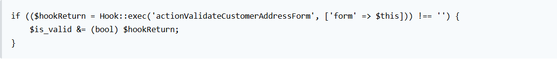

So i changed the code into:
And now my address is being saved properly in the back office and the front office.
