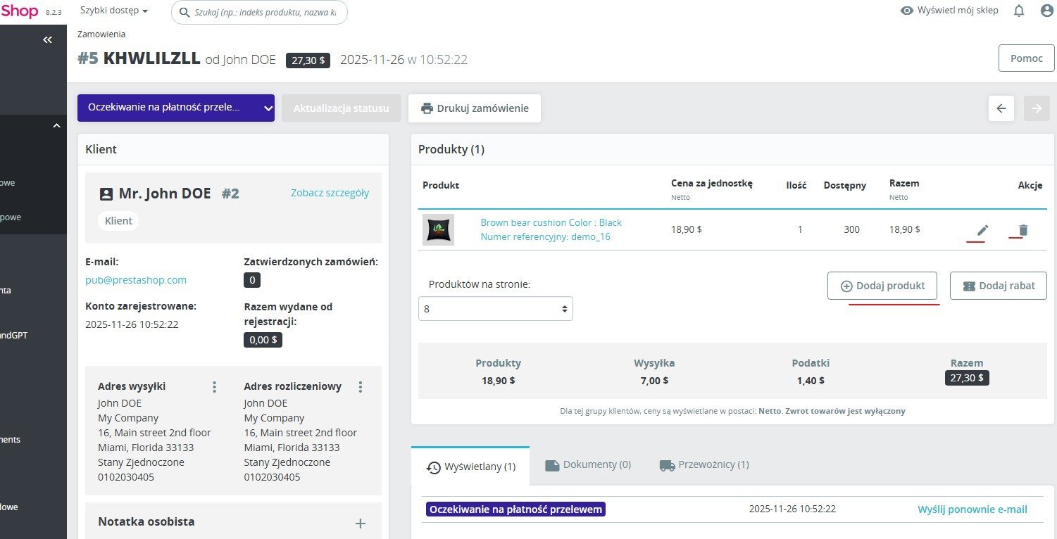

Christian69 Posted December 16, 2025 Author Share Posted December 16, 2025 Sorry but not on my, look the picture joint Link to comment Share on other sites More sharing options...

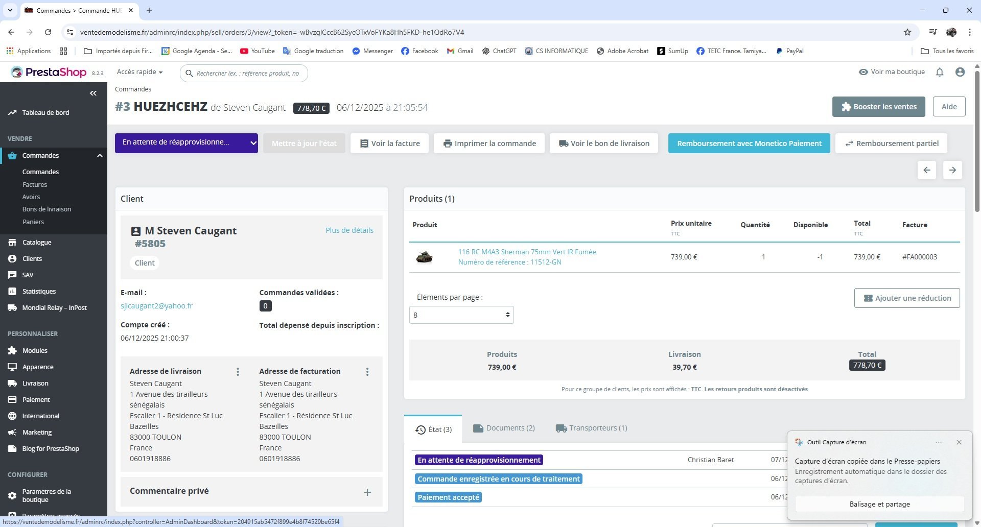

Christian69 Posted December 17, 2025 Author Share Posted December 17, 2025 Ben moi je sais pas quoi dire car quelque soit le statut je ne peux modifier la commande. Link to comment Share on other sites More sharing options...
