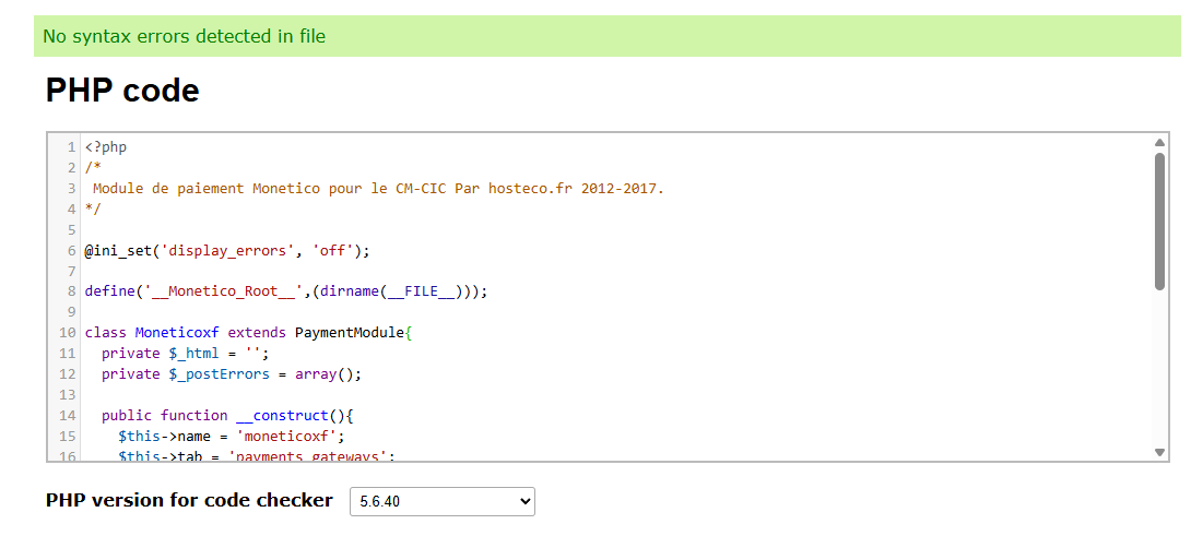

chti56 Posted December 9, 2025 Author Share Posted December 9, 2025 Voici le début du fichier moticoxf.php <?php /* Module de paiement Monetico pour le CM-CIC Par hosteco.fr 2012-2017. */ @ini_set('display_errors', 'off'); define('__Monetico_Root__',(dirname(__FILE__))); class Moneticoxf extends PaymentModule{ private $_html = ''; private $_postErrors = array(); public function __construct(){ $this->name = 'moneticoxf'; $this->tab = 'payments_gateways'; $this->version = '1.6.4.6'; parent::__construct(); $this->page = basename(__FILE__, '.php'); $nb_fois = Configuration::get('CMCIC4X_NBMENS'); $cmcic_active = (bool)Configuration::get('CMCIC_ACTIVE'); $cmcic4X_active = (bool)Configuration::get('CMCIC4X_ACTIVE'); if($cmcic4X_active && $cmcic_active) $n_fois = ' 1 & '. $nb_fois; if($cmcic4X_active && !$cmcic_active) $n_fois = ' '. $nb_fois; if(!$cmcic4X_active && $cmcic_active) $n_fois = ' 1 '; if(!$cmcic4X_active && !$cmcic_active) $n_fois = ' 0 '; $this->displayName = $this->l('CB Monetico Payement '). $n_fois .$this->l(' times'); Link to comment Share on other sites More sharing options...
Eolia Posted December 9, 2025 Share Posted December 9, 2025 Hum... curieux, je ne vois rien d'anormal ici. Link to comment Share on other sites More sharing options...

Eolia Posted December 9, 2025 Share Posted December 9, 2025 Commentez la ligne 6 du module (qui n'a pas grande utilité) en ajoutant // devant Link to comment Share on other sites More sharing options...

Eolia Posted December 9, 2025 Share Posted December 9, 2025 Vous avez bien commenté la ligne @ini_set('display_errors', 'off'); ??? Link to comment Share on other sites More sharing options...
chti56 Posted December 9, 2025 Author Share Posted December 9, 2025 (edited) Je viens de le faire... je n'avais pas commenté la bonne ligne... et quand j'essaye d'afficher les modules installés j'ai cette erreur: Parse error: syntax error, unexpected 'define' (T_STRING) in /home/sousleseuu/www/classes/module/Module.php(1361) : eval()'d code on line 8 [PrestaShop] Fatal error in module file :/home/sousleseuu/www/classes/module/Module.php(1361) : eval()'d code: syntax error, unexpected 'define' (T_STRING) Edited December 9, 2025 by chti56 (see edit history) Link to comment Share on other sites More sharing options...
Eolia Posted December 9, 2025 Share Posted December 9, 2025 Pouvez-vous m'envoyer le fichier moneticoxf.php (dans un zip) svp ? J'ai l'impression qu'il y a un souci de format. Link to comment Share on other sites More sharing options...
