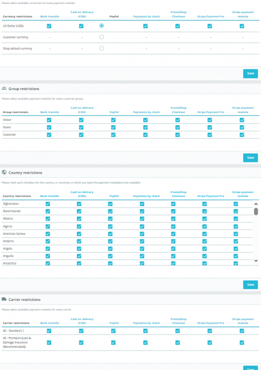

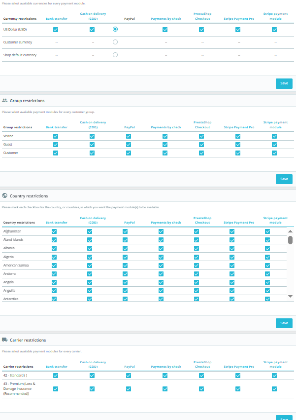

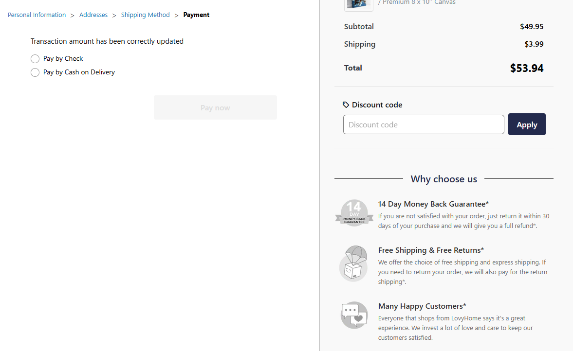

Mehdi Bourechka Posted November 16, 2025 Share Posted November 16, 2025 Hi everyone, I’m facing a persistent checkout issue and I’m hoping someone here can point me in the right direction. I initially tried to use the official Stripe module, but the connection wouldn’t work. It seems related to a webhook configuration problem that isn’t documented. In the past, the module used to automatically insert the webhook URL and required events through the “Connect with Stripe” button. With the latest version, this no longer works. After that, I tested a paid Stripe module from a third party developer. Payments are processed successfully on Stripe’s side, but the checkout still ends with an internal 500 error even though the order is created. As a last resort, I installed PrestaShop Checkout PS Checkout. I linked both my PrestaShop account and PayPal business account, but the module still doesn’t appear on the checkout page. To be sure there wasn’t a conflict, I disabled all other modules and still have the same result. For reference This issue is happening on PrestaShop 1.7.8 I also tested a fresh PrestaShop 9 installation. Same problem, PS Checkout doesn’t display during checkout I checked every setting under Payment Preferences all checkboxes I verified the module positions to ensure hooks are registered and everything looks normal I Asked AI but with no solution At this point, I’m stuck. If anyone has • A clue about what might block PS Checkout from appearing • A known fix for the Stripe module webhook issue • Recommendations for stable and reliable checkout or payment modules that work on 1.7.8 or 9 I would really appreciate any help or guidance. Thank you in advance to anyone who can point me in the right direction. Link to comment Share on other sites More sharing options...

Mehdi Bourechka Posted December 6, 2025 Author Share Posted December 6, 2025 Sorry for the late reply, my post was only approved recently, so I thought it had been forgotten for a while. About the PrestaShop checkout and Stripe: I’ve been testing different setups on several stores, and the results are honestly surprising. Using just the official Stripe module caused us to lose a lot of successful payments. Switching to a paid Stripe module from the marketplace improved things noticeably. But what’s even stranger is that after updating that same paid module to its latest version, we actually saw fewer payments being accepted again. That pushed me to dig deeper into how the payment step works and why transactions are being rejected. So far, the most stable and better-converting setup I’ve found is to redirect customers to Stripe Checkout instead of trying to handle everything directly inside the PrestaShop checkout with a module. Right now, for me, there’s no PrestaShop Stripe module that works perfectly in all cases, and redirecting to Stripe Checkout has been the most reliable solution in terms of conversion. Link to comment Share on other sites More sharing options...
