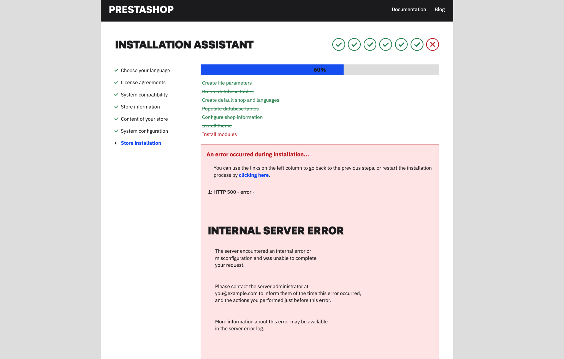

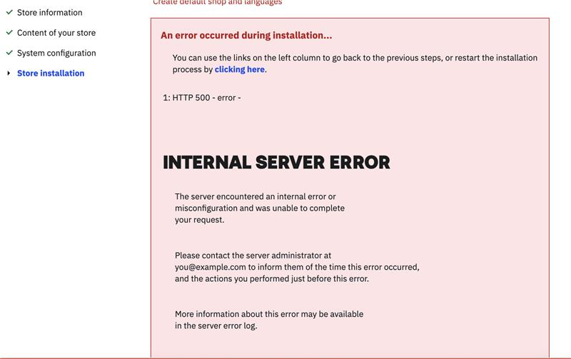

Santhosh S Posted November 6, 2025 Share Posted November 6, 2025 Hi, I am trying to install PrestaShop v9.0.0 and v9.0.1. During installation, I am encountering an HTTP 500 error in the 'Install themes' and 'Post-installation scripts' sections. Sometimes, the error occurs earlier in the 'Create default shop and languages' section. Could you please help me resolve this issue? Prestashop Version - 9.0.1 PHP -8.3.14 Link to comment Share on other sites More sharing options...

Santhosh S Posted Tuesday at 09:14 AM Author Share Posted Tuesday at 09:14 AM (edited) Hi, Still i was getting this error while installing 9.0.2-2.1 , i am using MAMP (mac os),I am encountering an HTTP 500 error in the 'Install themes' and 'Post-installation scripts' sections. Sometimes, the error occurs earlier in the 'Create default shop and languages' section. Could you please help me resolve this issue? Prestashop Version - v9.0.2-2.1 PHP -v8.3.14 MAMP -v7.2 On 11/21/2025 at 9:30 PM, darkin said: I was getting 500 error when there where problems with folder/file permissions. Try to make your mane folder (where you're installing presta, like /html/shop with permissions 777, check that mode_rewrite is enabled, check that apache conf file has AllowOveride All (if this setting is not on, later you'll get error when accessing Admin panel) -> using terminal or file manager open apache2.conf file for edit (/etc/apache2/apache2.conf) In that config file locate "<Directory /var/www/>" directive and look for "AllowOverride None" line and change to "AllowOverride All" Restart apache server Delete previous presta9 install and reinstall it. It worked for me and I can log into Back Office (admin account) Goodluck even i tried this ,still remain same... Edited Tuesday at 09:42 AM by Santhosh S (see edit history) Link to comment Share on other sites More sharing options...
