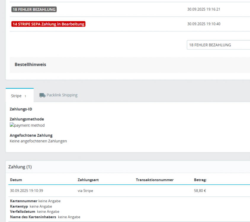

GrinGEO Posted October 29, 2025 Share Posted October 29, 2025 Hi have a few orders where the customer did not pay the order by digital payment, like stripe or paypal. Probably their bank refused the payment. I have the issue that I need to change the customer to bank wire, but I cant delete or modify the original payment, even not in PresTool. Is there any other workaround? becouse any modification I try the original payment is set again. Link to comment Share on other sites More sharing options...
Daresh Posted October 29, 2025 Share Posted October 29, 2025 It's not easy because in general, payment modules may have their own tables in the database, storing additional data related to orders. So changing a payment method to another one would require knowing it precisely and what it requires. Maybe that's why there is no such functionality in PrestaShop. Even if you change the payment related columns in the database (prefix_orders table), the Stripe module that you have may keep some data related to that order. So to change the payment method in a clean way, it would be recommended to also remove everything related to that order from Stripe's tables. Link to comment Share on other sites More sharing options...
GrinGEO Posted October 30, 2025 Author Share Posted October 30, 2025 Hi Daresh Yes you are right. If I use order manager module and change the payment type, effectively Stripe overwrites it. The problem is now that the customer did not pay by Stripe, becouse his bank refused the payment. The easiest would be to modify the payment type to bank, or just be able to disable stripe on that order for example. Or I need to cancel the order and make a new one. Link to comment Share on other sites More sharing options...
Daresh Posted October 30, 2025 Share Posted October 30, 2025 Exactly! So the question is does this order got sent to Stripe and it will overwrite it all the time, or can it be removed on the store level (from some Stripe database tables). Probably some custom module would be required here, one that knows what Stripe does and is able to remove some information from it. Link to comment Share on other sites More sharing options...
alex_developer Posted October 30, 2025 Share Posted October 30, 2025 Most likely, the Stripe module has its own table in the database, such as ps_stripe_orders. Search for a similar table in the database and delete this order from it. Then change the payment method. After that, requests from Stripe for this order will simply be ignored by this module. Link to comment Share on other sites More sharing options...

GrinGEO Posted November 3, 2025 Author Share Posted November 3, 2025 Yes Stripe is overwriting it all time. So there is no way to delete this payment, even if it failed. In my opinion this is a PS major issue. Becouse payments can always fail. In this case you should be able to assign a new payment. @El Patron: Yes would be simpler. In this special case we already shipped the parcels and we have tracking synched with this order over Packlink. But probably is better to cancel the order and make new one instead of losing time. Link to comment Share on other sites More sharing options...
