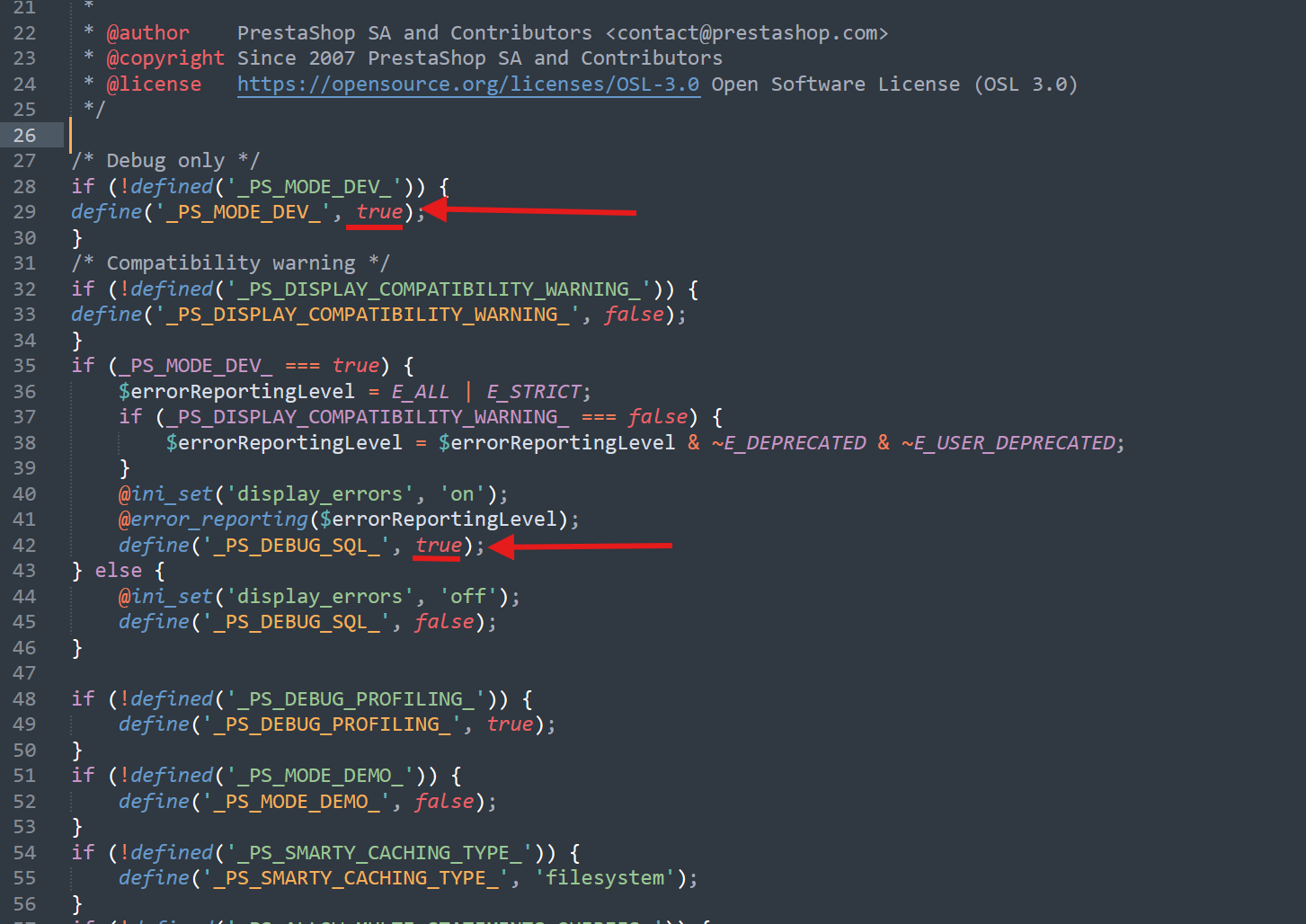

alex_developer Posted October 28, 2025 Share Posted October 28, 2025 Enable debug mode in the config\defines.inc.php file Change the _PS_MODE_DEV_ parameter to true And the _PS_DEBUG_PROFILING_ parameter to true Then, when you load the back office, you will be able to see where and what errors there are. Also, check the nginx or apache logs, depending on which server Prestashop is running on. 1 Link to comment Share on other sites More sharing options...
