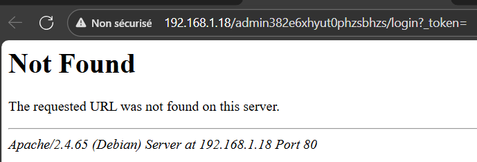

mayeul.gauthier Posted October 24, 2025 Share Posted October 24, 2025 Hello, I installed PrestaShop (version 9.0.1 - 1.0) downloaded from the official website. I followed the standard installation procedure, but at the end of the installation, I can’t access my admin dashboard — I’m getting a 404 error. I did make sure to use the correct name of the /admin folder, which was automatically renamed at the end of the installation. Here are more details about my environment: Debian 12 PHP: 8.4 Apache2 MariaDB Here’s what I’ve already tried — without success: Renaming the folder and restarting Apache Installing PHP version 8.3 Recreating the machine from scratch Restoring the /admin folder from the .zip before installation Do you have any idea what I could try next? Thanks in advance. Link to comment Share on other sites More sharing options...

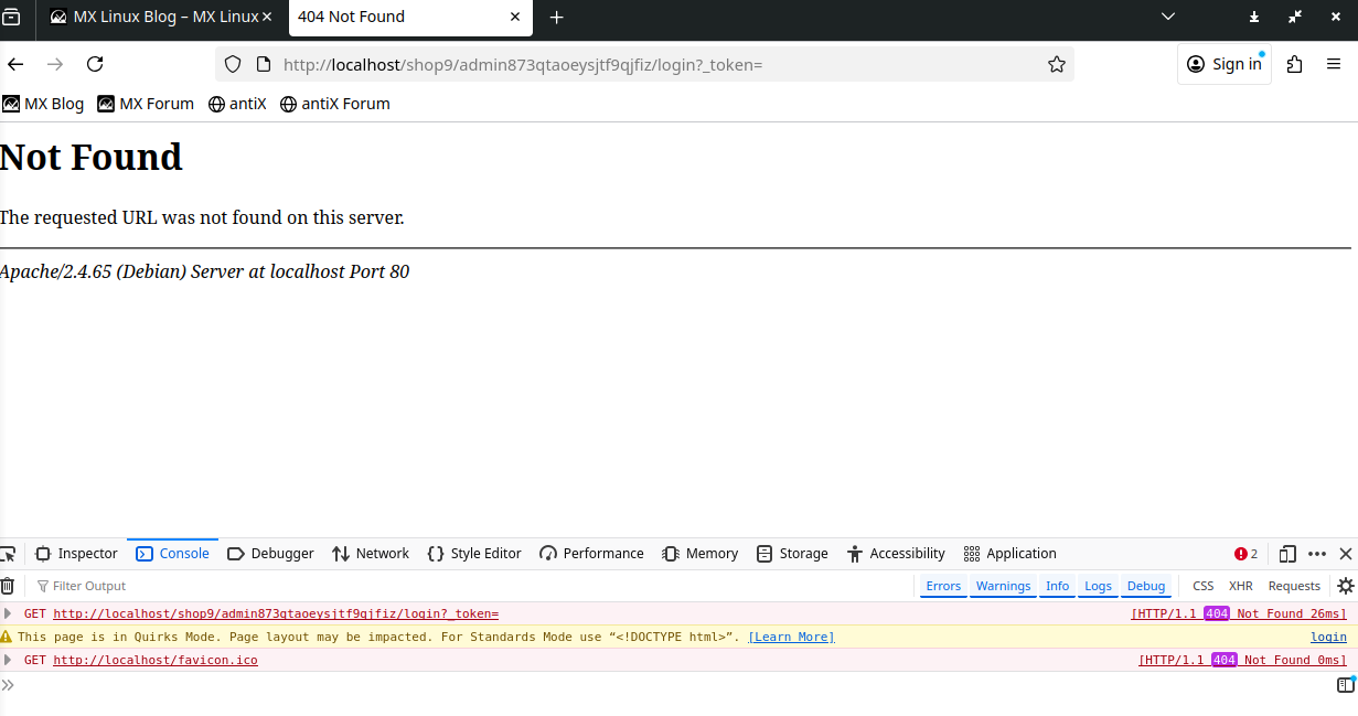

El Patron Posted November 12, 2025 Share Posted November 12, 2025 (edited) From your screenshot it looks like you’re getting an Apache 404, not a PrestaShop one. URL: …/shop9/admin873…/login?_token=… Apache is trying to open a real folder /admin873…/login and can’t find it, instead of passing the request to index.php in the admin folder. In PS 9 the /login URL only works if URL rewriting is active in Apache and the .htaccess in the admin directory is being used. 1. Make sure mod_rewrite is enabled sudo a2enmod rewrite sudo systemctl restart apache2 2. In your Apache vhost for localhost the shop path must allow overrides, e.g. <Directory /var/www/html> AllowOverride All </Directory> 3. Check that you have an .htaccess file in both /shop9/ and /shop9/admin873…/. If the admin .htaccess is missing, copy it from a fresh PS9 install or re-generate it. http://localhost/shop9/admin873…/index.php Edited November 12, 2025 by El Patron (see edit history) Link to comment Share on other sites More sharing options...
darkin Posted November 14, 2025 Share Posted November 14, 2025 El Patron, thanks for help, but presta 9 refuses from running properly on my linux machine (as I mentioned somewhere before even presta 9.0.0 was running fine on windows machine) mode rewrite is running. Think if this module would not be running my presta 8.2 on this same localhost (just other folder) will have problems, but it's running fine. .htaccess is in admin873... and in admin-api folders.... Always thought that it is a program (aka presta) is saying for Apache where to look for something. There's no login folder in admin folder so there's no chances to find it. And same Apache is looking for favicon file in wrong place and can't find it (another Apache or presta problem?) 1 Link to comment Share on other sites More sharing options...
