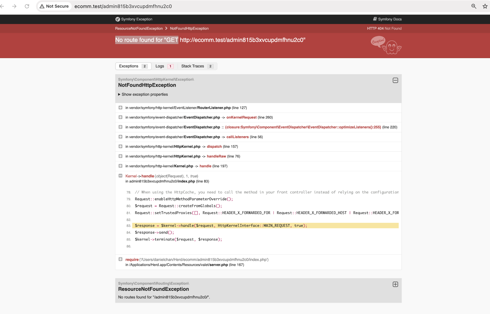

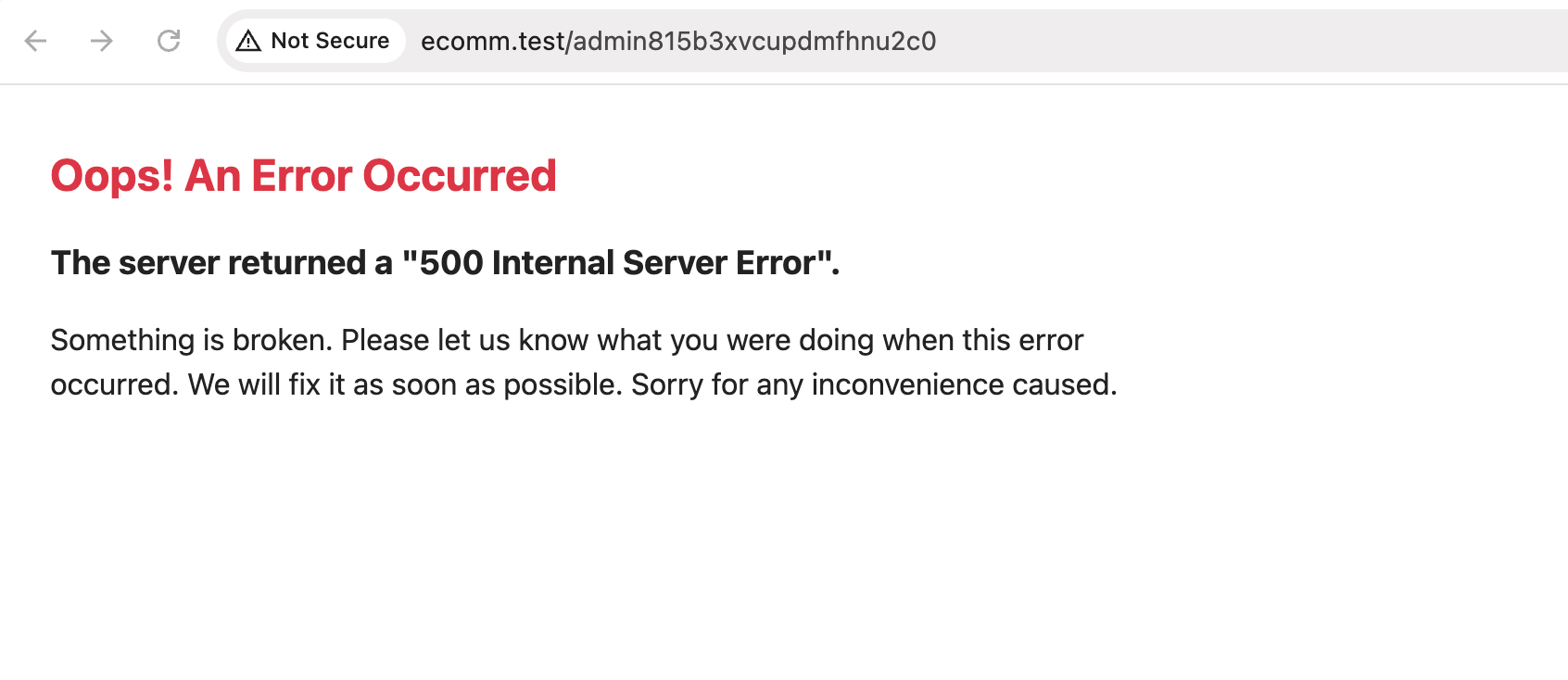

Daniel Chaniago Posted October 22, 2025 Author Share Posted October 22, 2025 10 hours ago, El Patron said: php 8,3 is official supported php version for ps9 https://prestaheroes.com/blogs/prestashop-alerts/best-php-version-for-prestashop-9 change php level and see if that helps Thank you, @El Patron, for your suggestion to fix my issue. I've tried following the steps in the link, and the results are as follows. Are there any other settings I should make? Link to comment Share on other sites More sharing options...
El Patron Posted October 23, 2025 Share Posted October 23, 2025 On 10/21/2025 at 7:38 PM, Daniel Chaniago said: Thank you, @El Patron, for your suggestion to fix my issue. I've tried following the steps in the link, and the results are as follows. Are there any other settings I should make? Hi, you will (always) need to look at log or enable debug mode to get the underlying error, 500 obfusificates the real error. here is another blog article that may help https://prestaheroes.com/blogs/prestashop-alerts/how-to-enable-prestashop-debug-mode-v8-v9 note I've done two 9.0.1, heck even a 9.0.0...they both installed...I will give you my best good, use the latest stable prestashop 8, ps9 is still not really ready for prime time unless you have tech skills to fix bugs. Link to comment Share on other sites More sharing options...
