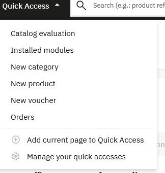

jameswill Posted October 15, 2025 Share Posted October 15, 2025 Hello , I was in the process of manual installation of Prestashop 9.0.1 on Alma Linux 8.1, PHP 8.1, MYSQL 5.7, Apache 2.4. However post successful installation, Quick search links are throwing 404. What could be the issue. Rest everything works fine. The links are mentioned in screenshot below. Kindly let me know. Link to comment Share on other sites More sharing options...

jameswill Posted October 23, 2025 Author Share Posted October 23, 2025 Hello @JBW, For your kind information, I have installed Prestashop in subdirectory i.e /home/{{USER-NAME}}/public_html/manual/presta901 I checked the quick access links and they seem to be pointing to the wrong directory i.e : https://example.com/admin9709vnyszwmjfzktuyr/index.php/improve/modules/manage?_token={{TOKEN}} instead of https://example.com/manual/presta901/admin9709vnyszwmjfzktuyr/index.php/improve/modules/manage?_token={{TOKEN}} like the left menu points to. I am having issue only in the quick access links. Is this a bug?. Link to comment Share on other sites More sharing options...

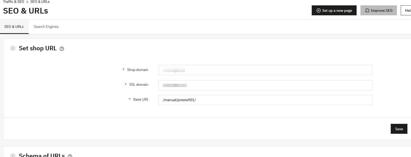

jameswill Posted October 23, 2025 Author Share Posted October 23, 2025 (edited) Hello @JBW, Yes, I did check that and it's set correctly. Edited October 23, 2025 by jameswill (see edit history) Link to comment Share on other sites More sharing options...
