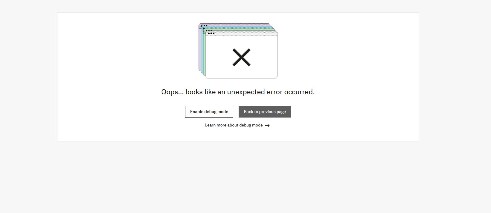

Mr. Trice Posted August 10 Share Posted August 10 (edited) After installing PrestaShop for the first time with Softaculous. I tried opening the back office but can't open it. It opens with an error. Now I have turned on the debug error, but I don't understand where the error is from. The front office works fine. Here is the link to the office for the error preview: (WORKS FINE NOW) After the solution below. What's the best solution, please? Edited August 11 by Mr. Trice All Resolved (see edit history) Link to comment Share on other sites More sharing options...
Andrei H Posted August 10 Share Posted August 10 Hello, This is a known issue. There is a fix on the public GitHub repository. You can either manually apply the code changes or wait for version 9.0.1 to be released, as the above fix was merged. 1 Link to comment Share on other sites More sharing options...

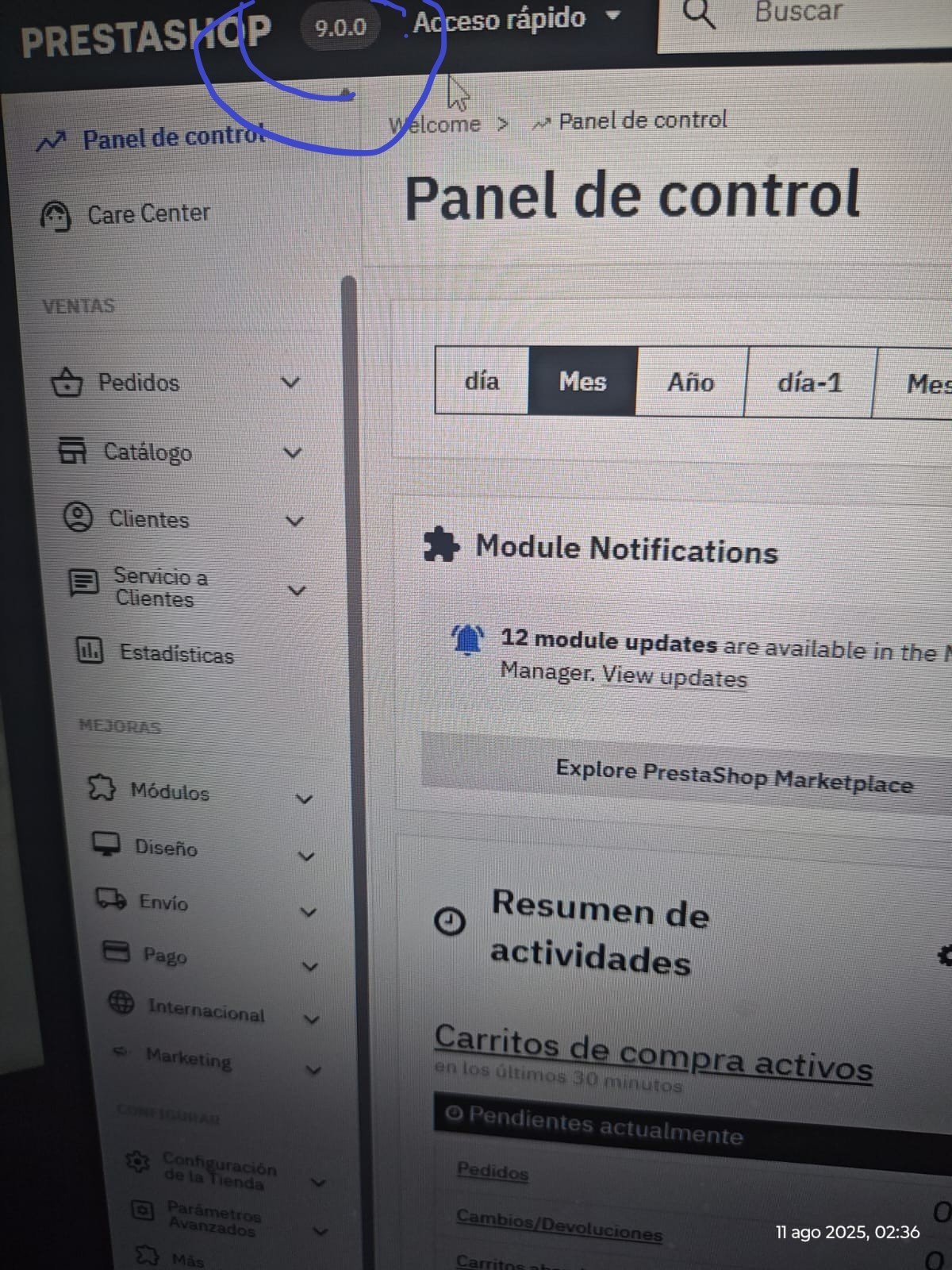

lflorencio Posted August 11 Share Posted August 11 23 hours ago, Andrei H said: Hello, This is a known issue. There is a fix on the public GitHub repository. You can either manually apply the code changes or wait for version 9.0.1 to be released, as the above fix was merged. Thank you Andrei I made this changes and now I can log gin on Backoffice. I made a Video and it was upload to youtube 2 Link to comment Share on other sites More sharing options...
