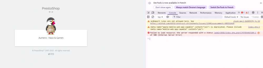

globalm1 Posted May 21, 2025 Share Posted May 21, 2025 Hello, Please, I need your help for the issue I'm facing. Recently I update my prestashop from 1.7 to 8.1.4, but now when I want to access to backOffice, I put my credentials but I got error POST https://www.aumero.de/admin3868/index.php?rand=1747852960949 500 (Internal Server Error) I use prestashop 8.1.4 and PHP Version 8.1.19 The debug mode is actf Greetings Link to comment Share on other sites More sharing options...
ComGrafPL Posted May 21, 2025 Share Posted May 21, 2025 Have you cleared the cache in VAR directory after update? Tried on other / secured browser? Also if you have custom modules try with manual disable and retry. Link to comment Share on other sites More sharing options...
Eolia Posted May 21, 2025 Share Posted May 21, 2025 What does the error.log say on your server ? Link to comment Share on other sites More sharing options...
Prestashop Addict Posted May 22, 2025 Share Posted May 22, 2025 Hi, you should not provide admin url, this can give facilities to attackers 😞 Link to comment Share on other sites More sharing options...
