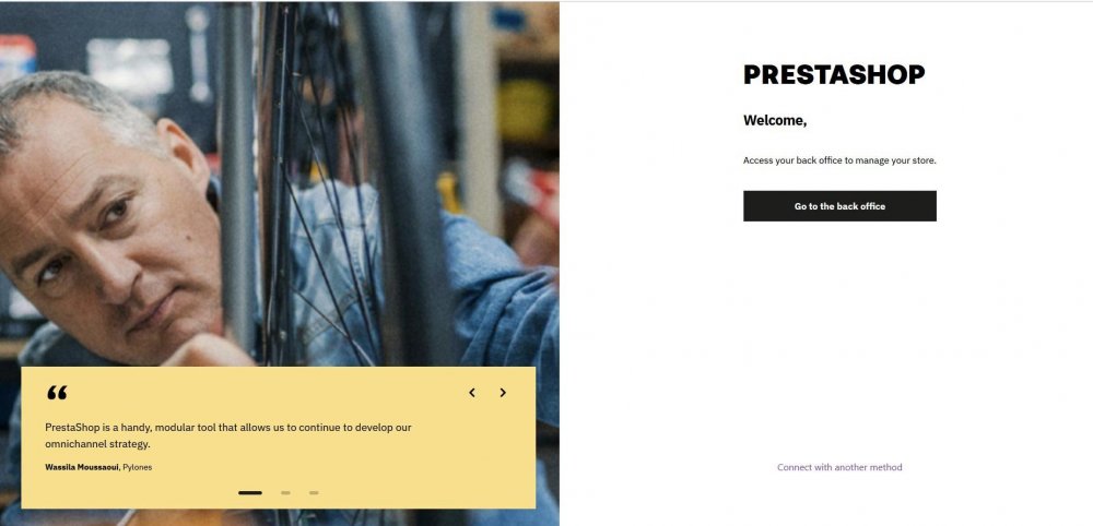

Rizzzle Posted May 15, 2025 Share Posted May 15, 2025 Hello, Pic attached. Is there any way to go back to the default backoffice login? We don't want this under any circumstances. Have disabled the sneaky module and it still remains. Thanks Link to comment Share on other sites More sharing options...
Webkul Solutions Posted May 15, 2025 Share Posted May 15, 2025 To display the default backoffice login, you have two options: 1) Disable or uninstall the "PrestaShop Account" module from your Back Office. 2) On the login screen, click "Connect with another method" to use the default Back Office login form. Link to comment Share on other sites More sharing options...
Rizzzle Posted May 15, 2025 Author Share Posted May 15, 2025 6 minutes ago, Webkul Solutions said: To display the default backoffice login, you have two options: 1) Disable or uninstall the "PrestaShop Account" module from your Back Office. 2) On the login screen, click "Connect with another method" to use the default Back Office login form. Thanks for the reply. I have done these steps. The hijacked Backoffice screen still remains. I want it to go exactly like it was before. I did not give Prestashop permission to make a permanent alteration to my site. I have come up with a solution that bypasses this (will share to anyone via DM), but I want it permanently gone, it's unnecessary. Installing that PrestashopAccount module seems to have permantly altered the backoffice login. Thanks, Link to comment Share on other sites More sharing options...
Webkul Solutions Posted May 15, 2025 Share Posted May 15, 2025 Have you tried renaming the module folder? Navigate to the following path and try renaming the ps_accounts folder:Path: /root_dir/modules/ps_accounts Link to comment Share on other sites More sharing options...
