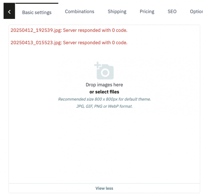

garyc22 Posted April 13, 2025 Share Posted April 13, 2025 (edited) My two sites were fine on Thursday when i last added some products. I've gone in today and when i try and upload an image, it fails and i get the following message: Server responded with 0 code . This is happening on both sites. I have tried a different browser, cleared the Prestashop cache and browser cache, tried different WiFis in case of an ISP issue, and it doesn't work. But, file upload works from my mobile (BUT, only if downloaded locally to the phone - i get the same error if trying to upload from iCloud/Dropbox from my mobile). If trying to upload from a local file destination or Dropbox on the laptop, i am still getting the error, unlike on the phone, where if the image is on the local device, it uploads successfully. PrestaShop 8.1 PHP 8.1.32 and 8.3.19 tried Server side PHP settings (i cannot change): Performance and security settings memory_limit 128M (Default) max_execution_time 30 (Default) max_input_time 60 (Default) post_max_size 8M (Default) upload_max_filesize 2M (Default) (although this allows me to upload files 6+ mb) opcache.enable on (Default) disable_functions opcache_get_status Hosting provider issue or maybe they made some changes? I tried turning on debug mode and got a deprecated message in the log: User Deprecated: Since api-platform/core 2.7: The service "ApiPlatform\Core\Bridge\Symfony\Routing\IriConverter" is deprecated, use ApiPlatform\Symfony\Routing\IriConverter instead But considering i found uploading from local files on my mobile works, i assume this isn't the problem. There haven't been any back end PrestaShop changes or modules which need updating since? Edited April 13, 2025 by garyc22 Added PHP info (see edit history) Link to comment Share on other sites More sharing options...
Webkul Solutions Posted May 2, 2025 Share Posted May 2, 2025 You can try these two ways. 1) Try to give 777 permission to the img folder and its subfolder too. 2) Try by clearing the cache by removing /var/cache/dev and /var/cache/prod folders. Link to comment Share on other sites More sharing options...
Nickz Posted May 2, 2025 Share Posted May 2, 2025 On 4/13/2025 at 11:55 AM, garyc22 said: My two sites were fine on Thursday when i last added some products. On 4/13/2025 at 11:55 AM, garyc22 said: Hosting provider issue or maybe they made some changes? You are on the right track. Do you have 2 prestashop on a shared hoster? On a "normal" server you have all kind of configuration abilities, is your contracted hoster a cost convenient one? Link to comment Share on other sites More sharing options...
