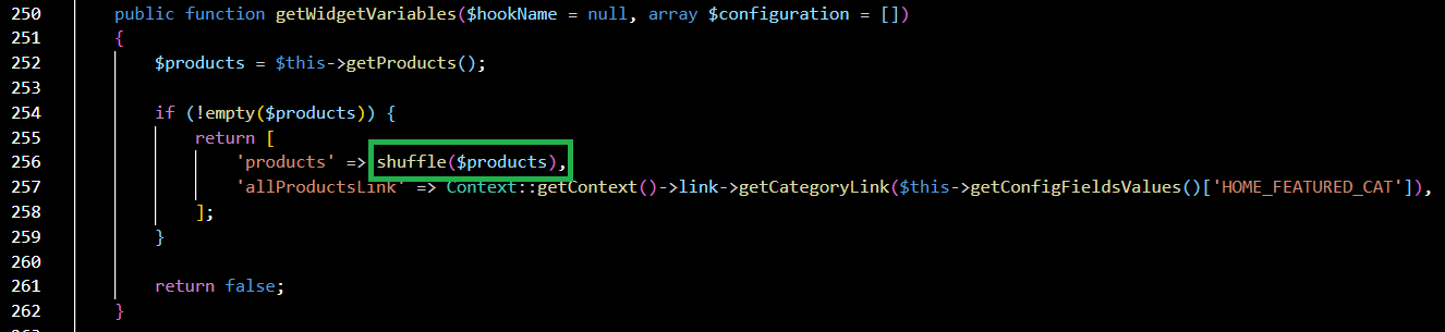

Daresh Posted February 21 Share Posted February 21 It is like that because of caching. A workaround is to send all 24 products to the template, then shuffle them and cut to 8. It requires some changes to the TPL file. Link to comment Share on other sites More sharing options...

Daresh Posted February 22 Share Posted February 22 Like I said before, it's cache. But not any issue but this module simply works this way. The randomization occurs when the module content gets generated, but before it's cached. So by default, you will never have a random effect on every page refresh with this module, just on every cache refresh. Link to comment Share on other sites More sharing options...

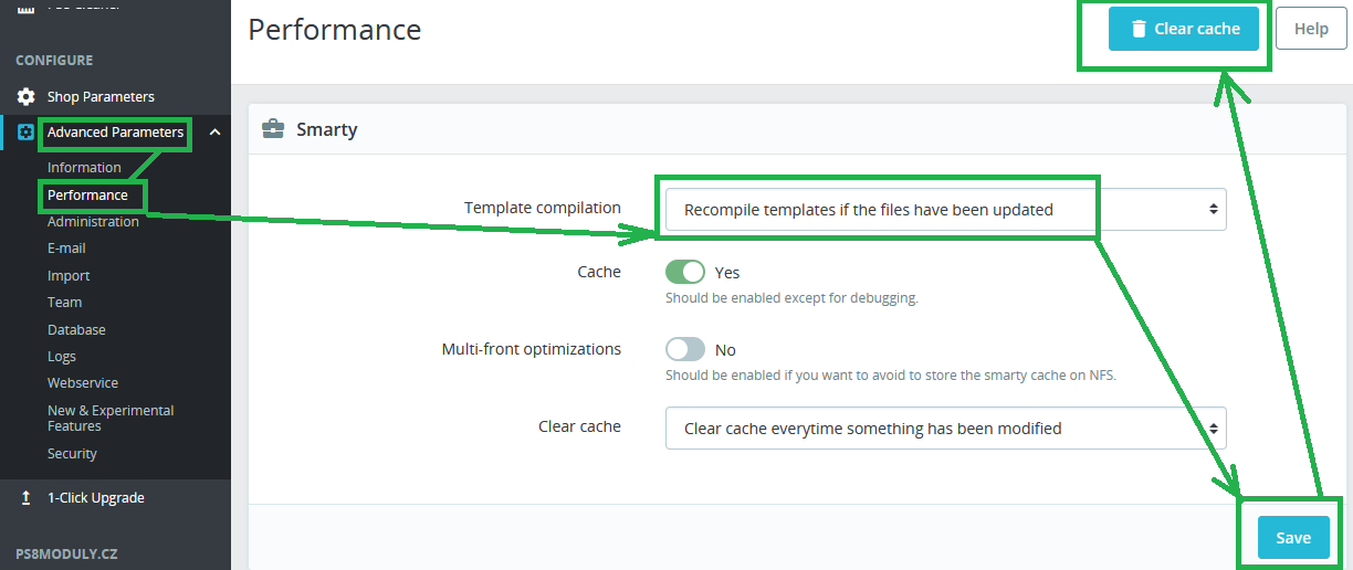

Daresh Posted February 23 Share Posted February 23 Clearing browser cache nas nothing to do with it, I bet that after you clear PrestaShop cache, order of products changes. Link to comment Share on other sites More sharing options...

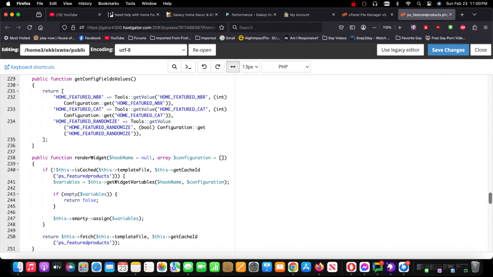

Daresh Posted February 23 Share Posted February 23 If you really need to have it random on each page load, you may try to disable cache use in the module: public function renderWidget($hookName = null, array $configuration = []) { //if (!$this->isCached($this->templateFile, $this->getCacheId('ps_featuredproducts'))) { $variables = $this->getWidgetVariables($hookName, $configuration); if (empty($variables)) { return false; } $this->smarty->assign($variables); //} return $this->fetch($this->templateFile); //return $this->fetch($this->templateFile, $this->getCacheId('ps_featuredproducts')); } 1 Link to comment Share on other sites More sharing options...
MrWade Posted February 23 Author Share Posted February 23 (edited) 5 hours ago, Daresh said: If you really need to have it random on each page load, you may try to disable cache use in the module: public function renderWidget($hookName = null, array $configuration = []) { //if (!$this->isCached($this->templateFile, $this->getCacheId('ps_featuredproducts'))) { $variables = $this->getWidgetVariables($hookName, $configuration); if (empty($variables)) { return false; } $this->smarty->assign($variables); //} return $this->fetch($this->templateFile); //return $this->fetch($this->templateFile, $this->getCacheId('ps_featuredproducts')); } Sorry, I just tried that. It didn't work. It removed the module from the main page. Edited February 23 by MrWade (see edit history) Link to comment Share on other sites More sharing options...
Daresh Posted February 23 Share Posted February 23 Did you replace the function with the one that I sent? What is the version of your module? Link to comment Share on other sites More sharing options...

Daresh Posted February 23 Share Posted February 23 You must have done something wrong with the code that I pasted. Please attach your ps_featuredproducts.php here Link to comment Share on other sites More sharing options...
MrWade Posted February 23 Author Share Posted February 23 (edited) 47 minutes ago, Daresh said: Did you replace the function with the one that I sent? What is the version of your module? My version is v2.1.5 and yes I did try your code and disable the cache I got a blank featured module. When I went back to the original code the module is back on the screen. Edited February 23 by MrWade (see edit history) Link to comment Share on other sites More sharing options...

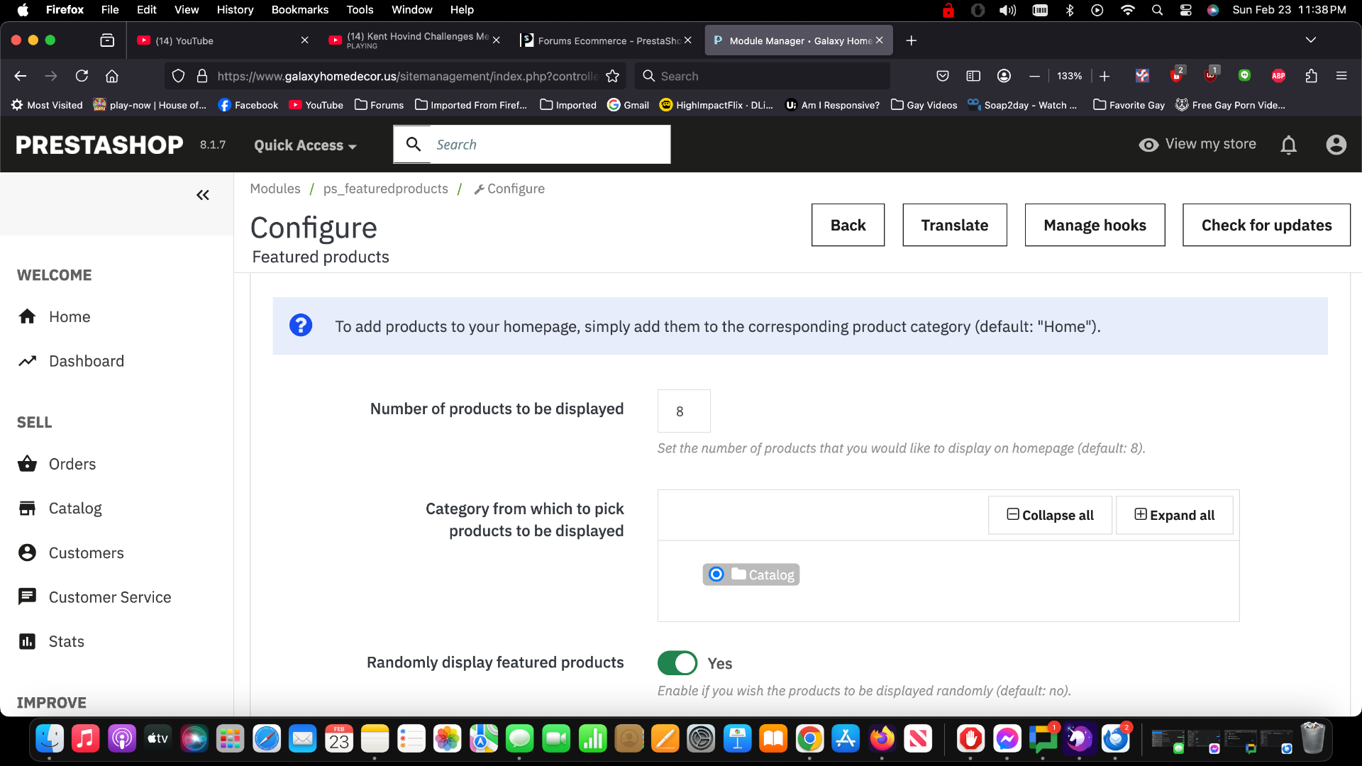

4presta Posted February 24 Share Posted February 24 We are interested in whether the settings in the module are saved. If the setting is saved, the value must be written to ps_configuration. If it doesn't register, it can't display randomly. Link to comment Share on other sites More sharing options...
MrWade Posted February 24 Author Share Posted February 24 1 minute ago, ps8modules said: We are interested in whether the settings in the module are saved. If the setting is saved, the value must be written to ps_configuration. If it doesn't register, it can't display randomly. According to my end (Back office) its show that is saved in module itself. Link to comment Share on other sites More sharing options...
4presta Posted February 24 Share Posted February 24 If you don't do what we ask you to do here, we can't help. There is printScr (print screen) on the keyboard, when you give us a picture of the ps_homefeatured module settings. Link to comment Share on other sites More sharing options...
MrWade Posted February 24 Author Share Posted February 24 3 minutes ago, ps8modules said: If you don't do what we ask you to do here, we can't help. There is printScr (print screen) on the keyboard, when you give us a picture of the ps_homefeatured module settings. Link to comment Share on other sites More sharing options...

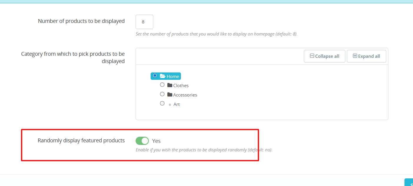

4presta Posted February 24 Share Posted February 24 Please go to the module settings page in the e-shop administration. Modules -> Module Manager -> Featured products (Configure) Link to comment Share on other sites More sharing options...
MrWade Posted February 24 Author Share Posted February 24 23 minutes ago, ps8modules said: Please go to the module settings page in the e-shop administration. Modules -> Module Manager -> Featured products (Configure) Here is my settings for the Featured Products Module. Link to comment Share on other sites More sharing options...

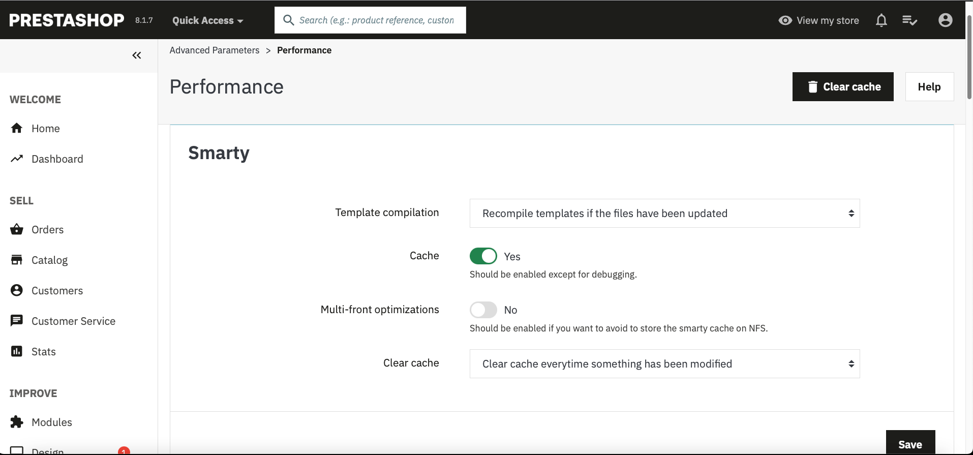

Daresh Posted February 24 Share Posted February 24 Does the order of products change after you go to Advanced -> Performance and clear PrestaShop cache? Link to comment Share on other sites More sharing options...
Knowband Plugins Posted February 24 Share Posted February 24 Change the renderWidget Function & Use the below code. public function renderWidget($hookName = null, array $configuration = []) { //if (!$this->isCached($this->templateFile, $this->getCacheId('ps_featuredproducts'))) { $variables = $this->getWidgetVariables($hookName, $configuration); if (empty($variables)) { return false; } $this->smarty->assign($variables); //} return $this->fetch($this->templateFile); } Link to comment Share on other sites More sharing options...
Knowband Plugins Posted February 24 Share Posted February 24 19 hours ago, MrWade said: This solution should work. Link to comment Share on other sites More sharing options...

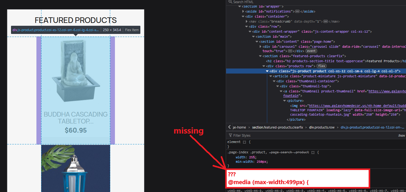

MrWade Posted February 25 Author Share Posted February 25 Ok I got the module going thanks to ps8modules for helping me. Now, how can I make the home featured products image full width of the mobile version and the font bigger too? Link to comment Share on other sites More sharing options...

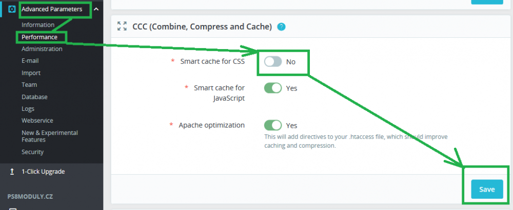

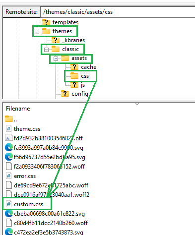

4presta Posted February 25 Share Posted February 25 (edited) https://help-center.prestashop.com/hc/en-us/articles/18898613995026-Customize-your-site-s-CSS ./themes/classic/assets/css/custom.css @media (max-width:499px) { .page-index .product, .page-search .product { width: 100% !important; min-width: 250px } .page-index .product-miniature .thumbnail-container, .page-search .product-miniature .thumbnail-container { width: 100% !important; } } Edited February 25 by ps8modules updated CSS (see edit history) Link to comment Share on other sites More sharing options...
MrWade Posted February 25 Author Share Posted February 25 8 hours ago, ps8modules said: https://help-center.prestashop.com/hc/en-us/articles/18898613995026-Customize-your-site-s-CSS ./themes/classic/assets/css/custom.css @media (max-width:499px) { .page-index .product-miniature .product, .page-search .product-miniature .product { width: 100%; min-width: 250px } .page-index .product-miniature .thumbnail-container, .page-search .product-miniature .thumbnail-container { width: 100% !important; } } custom.css 338 B · 0 downloads Ok, no change. Link to comment Share on other sites More sharing options...
4presta Posted February 25 Share Posted February 25 (edited) And again, we don't know if you uploaded everything correctly and to the right folder on FTP. And we don't know if you used the magic button in the performance settings "Clear cache". Edited February 25 by ps8modules (see edit history) Link to comment Share on other sites More sharing options...
MrWade Posted February 25 Author Share Posted February 25 6 minutes ago, ps8modules said: And again, we don't know if you uploaded everything correctly and to the right folder on FTP. And we don't know if you used the magic button in the performance settings "Clear cache". I did all that and yes it is in the right folder. Link to comment Share on other sites More sharing options...
4presta Posted February 25 Share Posted February 25 He didn't. If you did, the style is visible in the Inspector. Link to comment Share on other sites More sharing options...
MrWade Posted February 25 Author Share Posted February 25 2 minutes ago, ps8modules said: He didn't. If you did, the style is visible in the Inspector. That is what I put in the custom.css file and NO change. Link to comment Share on other sites More sharing options...
4presta Posted February 25 Share Posted February 25 Link to comment Share on other sites More sharing options...

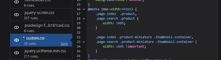

Knowband Plugins Posted February 25 Share Posted February 25 @ps8modules, I think shared CSS is not correct. I can't see a matching tag related to the selector. .page-index .product-miniature .product 1 Link to comment Share on other sites More sharing options...
4presta Posted February 25 Share Posted February 25 (edited) @media (max-width:499px) { .page-index .product, .page-search .product { width: 100%; min-width: 250px; } .page-index .product-miniature .thumbnail-container, .page-search .product-miniature .thumbnail-container { width: 100% !important; } } The problem is that you are editing the styles directly in theme.css. You can tell by the fact that your css is decompressed. Edited February 25 by ps8modules (see edit history) Link to comment Share on other sites More sharing options...
MrWade Posted February 25 Author Share Posted February 25 5 minutes ago, ps8modules said: @media (max-width:499px) { .page-index .product, .page-search .product { width: 100%; min-width: 250px; } .page-index .product-miniature .thumbnail-container, .page-search .product-miniature .thumbnail-container { width: 100% !important; } } That did it, Thank you. Link to comment Share on other sites More sharing options...
