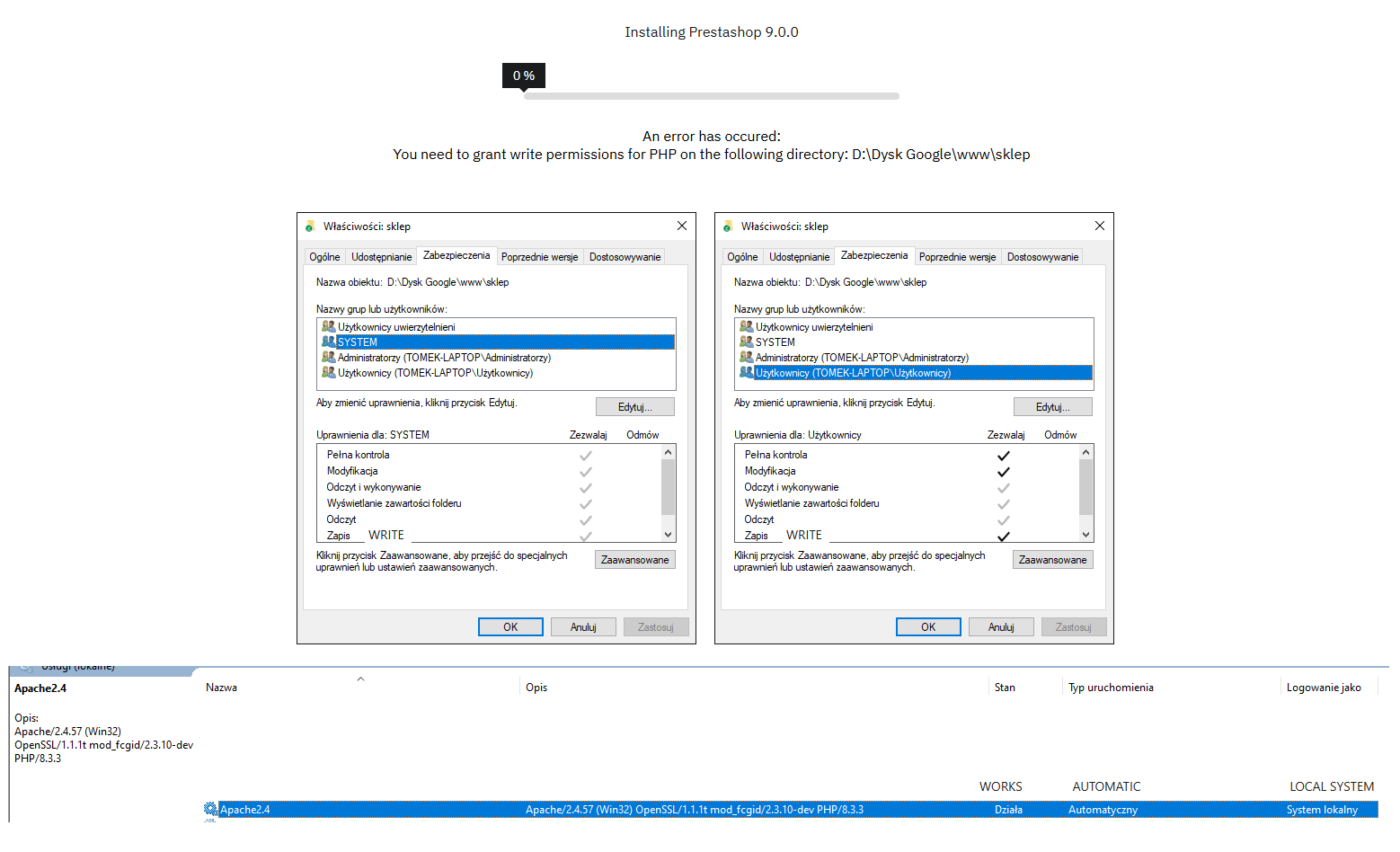

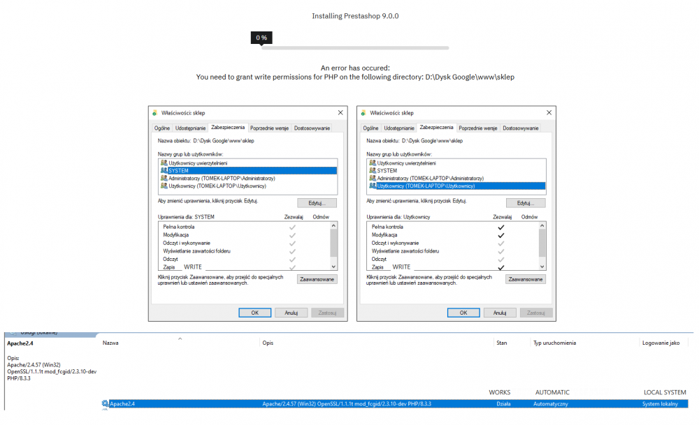

tomsyty Posted July 12, 2025 Share Posted July 12, 2025 What if it's Windows? The same error. Both local user and system have write permission to the directory, sample php file with file_put_contents function works creating the file. Link to comment Share on other sites More sharing options...

tomsyty Posted July 20, 2025 Share Posted July 20, 2025 (edited) This is Windows so setting permissions is a little bit different than in Linux, I know that it requires write and execute permissions, full permissions are granted (equivalent to 777 in Linux) but still doesn't work. Will try in WSL but it should work in Windows too, I have no problems with write permission when I use my own PHP scripts. Edit: Ok, looks it was Apache's configuration causing this problem (virtual host settings for this directory), changed and now it works. Edited July 20, 2025 by tomsyty (see edit history) Link to comment Share on other sites More sharing options...
