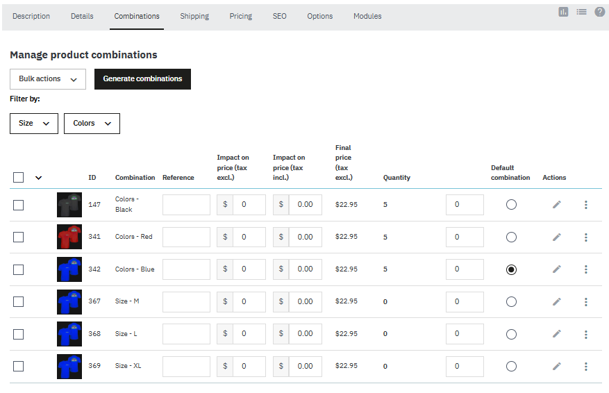

GamerWipes Posted July 25, 2024 Author Share Posted July 25, 2024 (edited) 7 minutes ago, Daresh said: You can generate combinations with many attributes, sizes and colors. Another approach is to create separate products for all the dfifferent colors, and only use combinations for sizes. Then add some module to link the products together, allowing the customer to jump between the colors. We implemented this kind of solution, along with indicating which sizes are available here: https://uniformsy.pl/kolekcja-soft/541-damska-sukienka-medyczna-timi-peach.html here is a screenshot of my product combination page. if i try to add sizes, it adds them as separate combinations, not as sub-combinations for the different colors. some shirts have 10+ colors, having a new product for each of them and flooding my page with tons of t shirts for all the color combinations is tacky and not acceptable. the site you sent me to got bombarded by 4 popups before i could ever see anything. i immediately closed the page. nobody wants to deal with that when visiting a store. you still didnt answer the question, you just directed me to buy another module. thats not what im asking. you said what i want to do is built into the software, so please help me by telling me where to find this feature. not by telling me to buy another module. thank you Edited July 25, 2024 by GamerWipes (see edit history) Link to comment Share on other sites More sharing options...

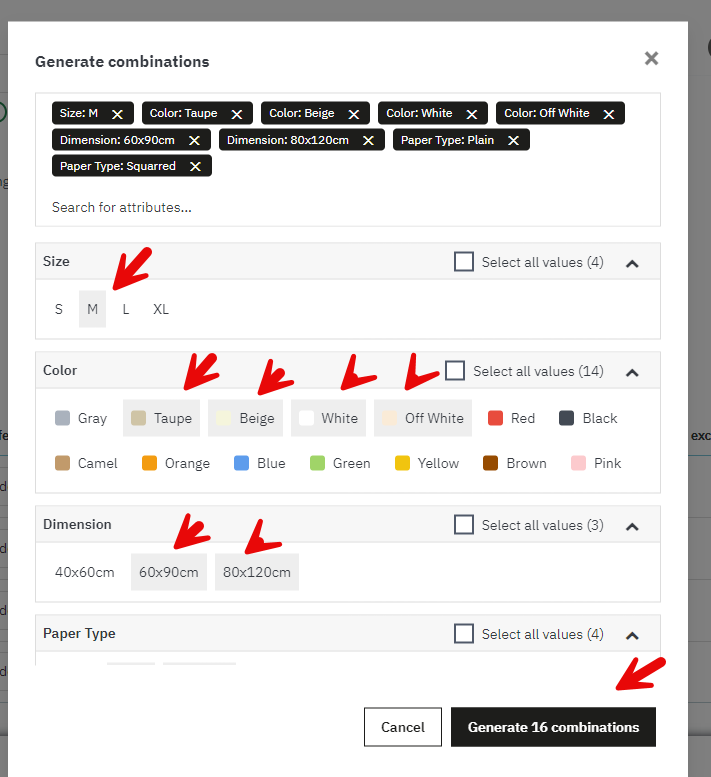

Daresh Posted July 26, 2024 Share Posted July 26, 2024 When generating combinations, you need to select both color and size. Even a default PrestaShop with demo products has examples for this, products having size / color combinations. https://demo.prestashop.com/ Link to comment Share on other sites More sharing options...
ecommerce16 Posted July 26, 2024 Share Posted July 26, 2024 As Daresh already said. This is a standard function. Simply check all the combinations: Size, color etc. you need and then generate combinations. Maybe not all colors are available in every size, but after yu generated the combinations you can delete the combinations who are not possible. Link to comment Share on other sites More sharing options...
GamerWipes Posted July 26, 2024 Author Share Posted July 26, 2024 14 hours ago, ecommerce16 said: As Daresh already said. This is a standard function. Simply check all the combinations: Size, color etc. you need and then generate combinations. Maybe not all colors are available in every size, but after yu generated the combinations you can delete the combinations who are not possible. Thank you for your help. My problem was that I was trying to add sizes to existing products, not realizing you have to add the colors and sizes at the same time for it to work. Thanks again Link to comment Share on other sites More sharing options...

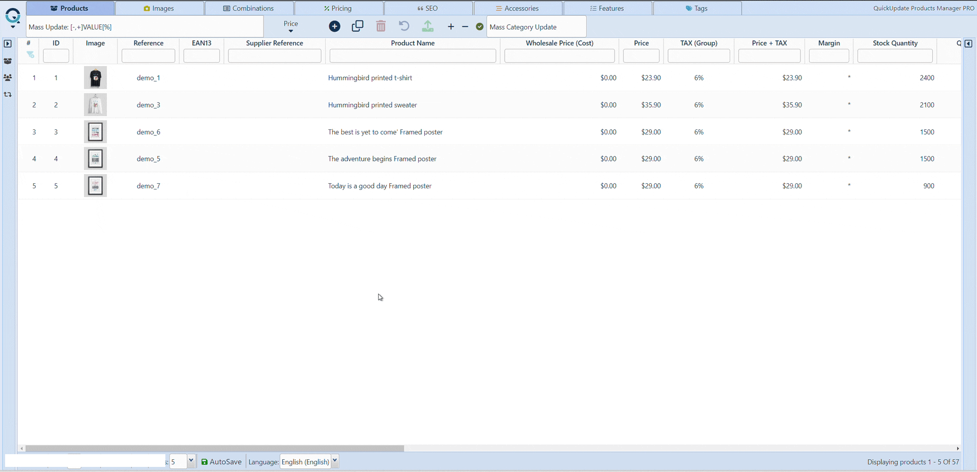

QuickUpdate.net Posted August 10, 2024 Share Posted August 10, 2024 (edited) We also have generation of product combinations in QuickUpdate (https://addons.prestashop.com/en/fast-mass-updates/45498-quickupdate-pro-the-expert-multitool-for-prestashop.html) You can generate all the combinations with only the attributes you want and how many you want and then update stocks and prices for them in bulk - let us know if it solves your specific use case. Edited August 10, 2024 by QuickUpdate.net (see edit history) Link to comment Share on other sites More sharing options...
