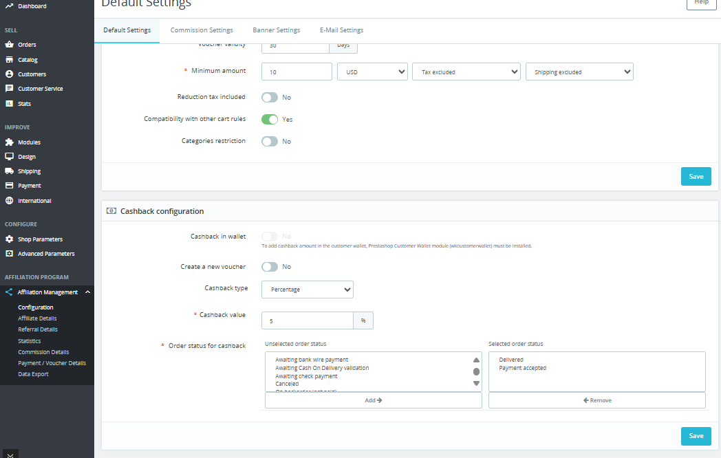

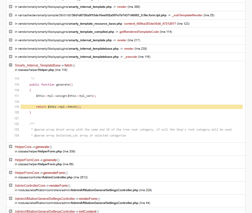

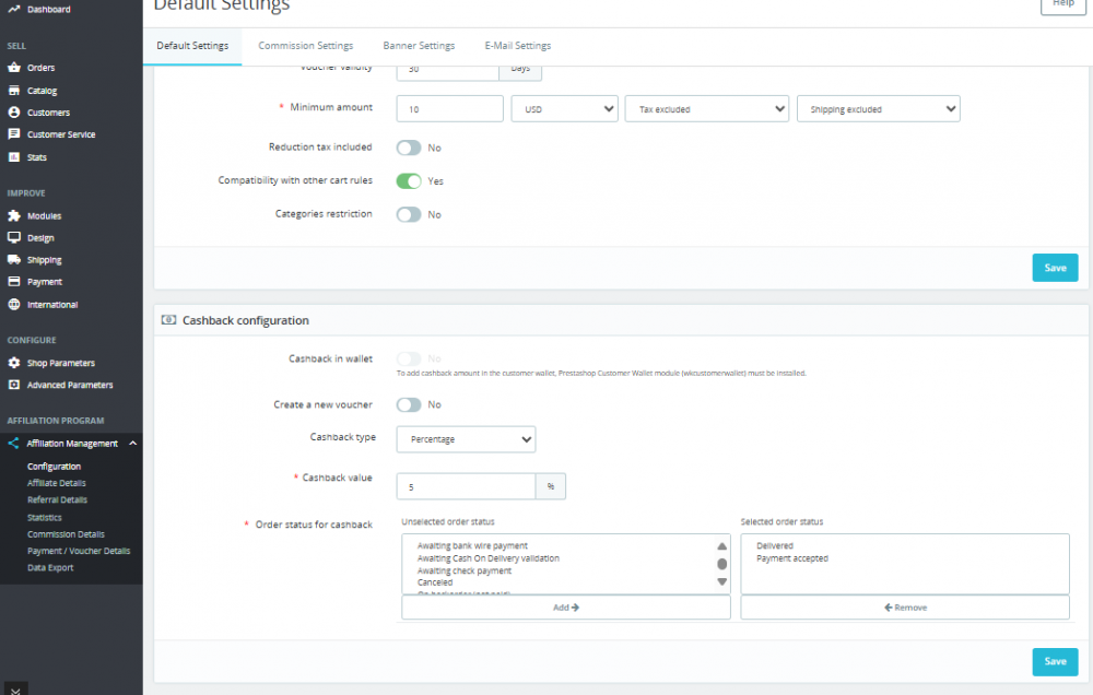

GamerWipes Posted July 20, 2024 Share Posted July 20, 2024 PS v8.1.5 ~ php v8.1 I just bought and installed the Webkul Affiliate module... Affiliate Program | Referral, Reward & Discount (prestashop.com) and i was going through the config settings, everything was fine. then i changed one setting and now im getting a .php error. ill try to include as much info as possible. this is the error from debug mode: to clarify what happened. each settings page/section for the module, i would make changes, then save. the page would refresh, and id go to the next section. when i got to the section at the bottom of the first page (cashback configuration), i clicked save, the page refreshed, and now i get this .php error and cant access the page. the screenshot here is from the demo, since i cant access the page on my own backend one thing to note. i can access all of the other sections of my back end, i can even access the other settings page for the affiliate module. the only page i cant access is the first configuration page for the module. so i cant make any changes to it. i even tried disabling the module and accessing the config page, and still get the .php error any help is greatly appreciated Link to comment Share on other sites More sharing options...

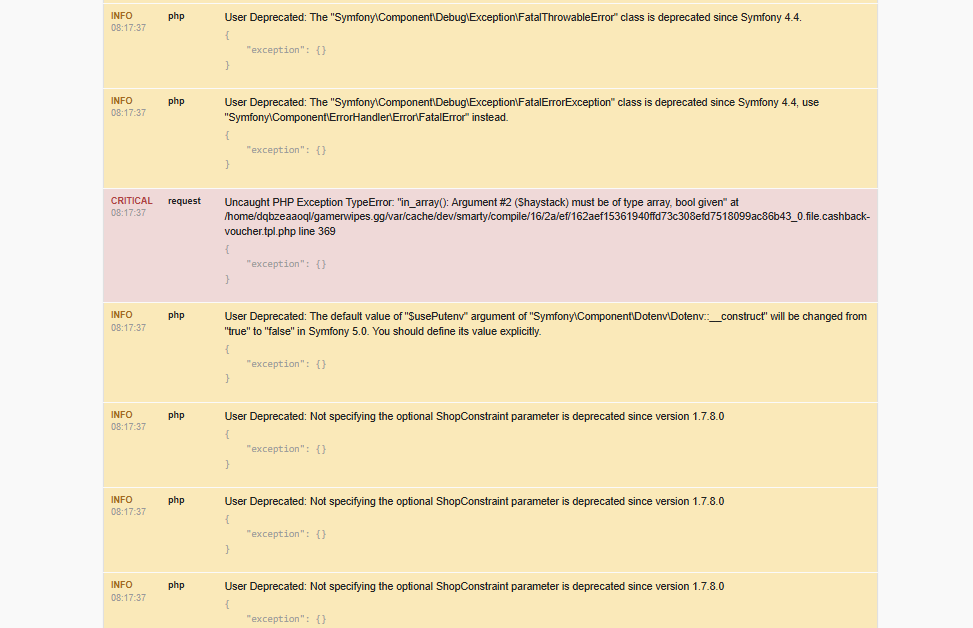

GamerWipes Posted July 20, 2024 Author Share Posted July 20, 2024 from the Logs page of debug, not sure if this helps any Link to comment Share on other sites More sharing options...
Nickz Posted July 20, 2024 Share Posted July 20, 2024 The module is not apt for the current PHP/Symphony version. Installing a module is always tricky, moreso if you are not a developer yourself. Install your store locally on localhost and test all there before you install modules. Its highly unlikely to find someone with knowledge of a particular module here. Present that error to the developer of the module together with your current settings. Link to comment Share on other sites More sharing options...
