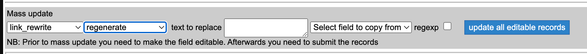

AcidLava Posted May 28, 2024 Author Share Posted May 28, 2024 Thank you for your feedback and your work. I just uploaded the files on my admin. But I can't find the product-edit.php related in the doc. Could you please explain me the process to Force Update of Simplified URLs and redirect them ? Link to comment Share on other sites More sharing options...
musicmaster Posted May 28, 2024 Share Posted May 28, 2024 3 hours ago, AcidLava said: Thank you for your feedback and your work. I just uploaded the files on my admin. But I can't find the product-edit.php related in the doc. Could you please explain me the process to Force Update of Simplified URLs and redirect them ? When you unzip the file you should find product-edit.php between the resulting files. To change the urls you need to regenerate the link_rewrite field (that is a mass edit function). Link to comment Share on other sites More sharing options...

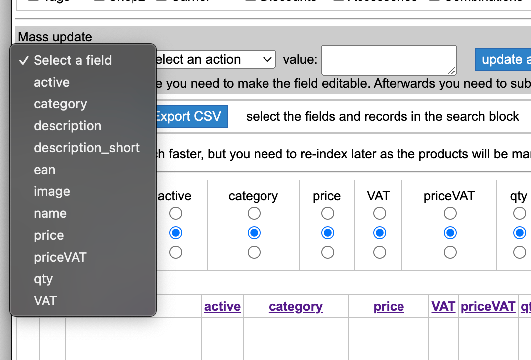

AcidLava Posted May 28, 2024 Author Share Posted May 28, 2024 Thank you, had an issue with FTP. By the way I can't find the link_rewrite field. Does this force the redirect too? Thank you ! Link to comment Share on other sites More sharing options...
musicmaster Posted May 28, 2024 Share Posted May 28, 2024 You have to select the field and then press the search button to include it. Link to comment Share on other sites More sharing options...

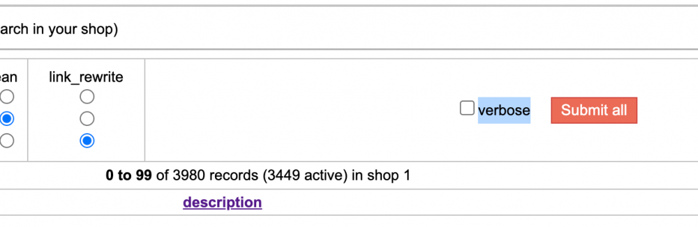

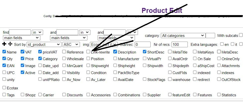

musicmaster Posted May 29, 2024 Share Posted May 29, 2024 4 minutes ago, AcidLava said: Merci pour votre retour. J'ai lancé une régénération hier mais ne voit pas de résultat à l'heure. That looks strange. It seems that there is a javascript error. Can you check for that? BTW: did you make the field editable in the hide-show-edit section? Link to comment Share on other sites More sharing options...
AcidLava Posted May 29, 2024 Author Share Posted May 29, 2024 No, do I have to check verbose and click on submit all after checking edit? Thanks. Link to comment Share on other sites More sharing options...
musicmaster Posted May 29, 2024 Share Posted May 29, 2024 (edited) - do the fields change when you click "update all records"? - do you press Submit All afterwards? Edited May 29, 2024 by musicmaster (see edit history) Link to comment Share on other sites More sharing options...

musicmaster Posted May 29, 2024 Share Posted May 29, 2024 1 hour ago, AcidLava said: Just sent you a video in PM. This way I cannot see the link_rewrite field. Please switch the description fields off the way you switched the link_rewrite field on. Please follow the right order: - first make the link_rewrite field editable - only then do the mass edit operation - check that things have been changed and then submit It looks like in the middle of the video a javascript error is happening that refreshes the page and sets it back to default. At the end all the rows disappear. I have never seen that before. the video isn't clear enough to understand what you are doing at that moment. At the moment your setting at the top is to show 100 rows. Please reduce that to 2 or 3. That is easier debugging. Link to comment Share on other sites More sharing options...

AcidLava Posted May 29, 2024 Author Share Posted May 29, 2024 When I update all editable records, the Link-Rewrite goes uncheck and disappear on the product lists. About non-latin char I don't think so but hard to say on +3000 products. Link to comment Share on other sites More sharing options...
