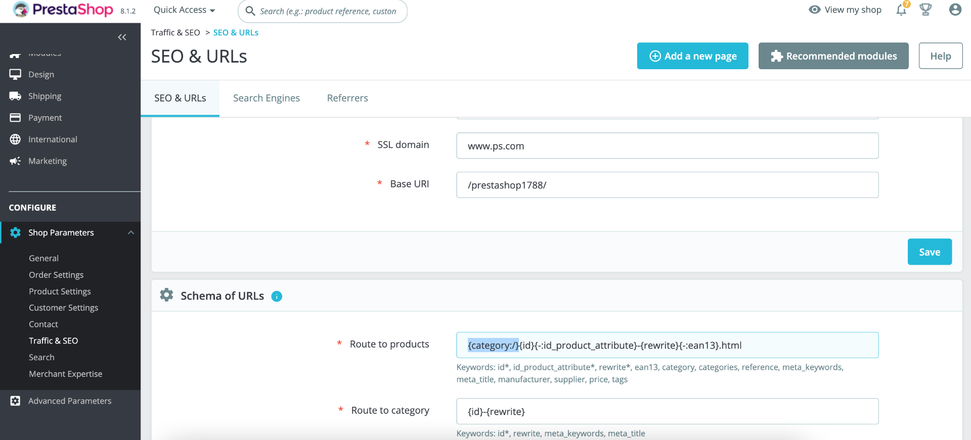

szbstvn Posted March 24 Share Posted March 24 Hello is possible to remove category from url? example.com/category/1-product .... this work! example.com/1-product .... go to 404 How can do it (prestahop 8.1.5) Link to comment Share on other sites More sharing options...
Mediacom87 Posted March 25 Share Posted March 25 Hi, This isn't really possible, since if you remove the {catgory:/} element from the product URL configuration, you'll end up confusing it with the category URLs. What you can do is replace it with a generic term, such as p/, which would give the following result in the URL configuration: p/{id}{-:id_product_attribute}-{rewrite}{-:ean13}.html Link to comment Share on other sites More sharing options...
Mediacom87 Posted March 25 Share Posted March 25 I just tested it by removing {category:/} in the URL configuration and it works perfectly. Link to comment Share on other sites More sharing options...

szbstvn Posted March 25 Author Share Posted March 25 5 hours ago, Mediacom87 said: I just tested it by removing {category:/} in the URL configuration and it works perfectly. How??? Link to comment Share on other sites More sharing options...
szbstvn Posted March 25 Author Share Posted March 25 3 hours ago, ZHSoft said: * Route to products, delete the category, and support free customization. I done but doesn't work. ComGrafPL did it and working but if I try myself then doesn't work. Hedidnt say how 🙂 . Change route - save - Friendly url off - save - friendly url off - save .... "Regenerate" htacces When I try remove ".html" then (after the friendly url off - save - on save) the result is same to base situation. Link to comment Share on other sites More sharing options...

szbstvn Posted March 25 Author Share Posted March 25 (edited) 2 hours ago, Mediacom87 said: I haven't yet installed an 8.1.5 version, I've just tested it on an 8.1.3 without any problems. This is where I'm going to go crazy... I deleted ".html" and it has the same result as when I started topic. If I write back the ".html" then it works. Of course, "category/' is no longer included. Fortunately, at least that's good. I follow the procedure described in several places... Route modify - Freiendly URL off - save - friendly URL on - save - clear cache. Result that the page you are looking for could not be found, i.e. 404 ... It didn't work for 8.1.4 either. After that, I upgraded to 8.1.5. That's what makes you right, and it's really because of the version. How can I report the suspected error to the development? ... Im switch on debug: "An exception has been thrown during the rendering of a template ("Warning: filesize(): stat failed for /XXXXXXXXXXXXXXXXXXXXXXXXXXXXXXXXXXXXXXXXXXXXXXXXX/var/cache/dev/appParameters.php")." When i save change in admin on SEO & URL page Edited March 25 by szbstvn (see edit history) Link to comment Share on other sites More sharing options...

szbstvn Posted March 26 Author Share Posted March 26 Maybe it's just new to me... I deleted the whole thing and installed 8.1.4. 1. I deleted {category:/} = works 2. I also deleted ".html" = does not work 3. I put {category:/} back without ".html" = it works. So either one or the other can be removed, but both cannot. Link to comment Share on other sites More sharing options...
Mediacom87 Posted March 26 Share Posted March 26 il y a 26 minutes, szbstvn a dit : So either one or the other can be removed, but both cannot. This leads to confusion between categories and products. Link to comment Share on other sites More sharing options...
