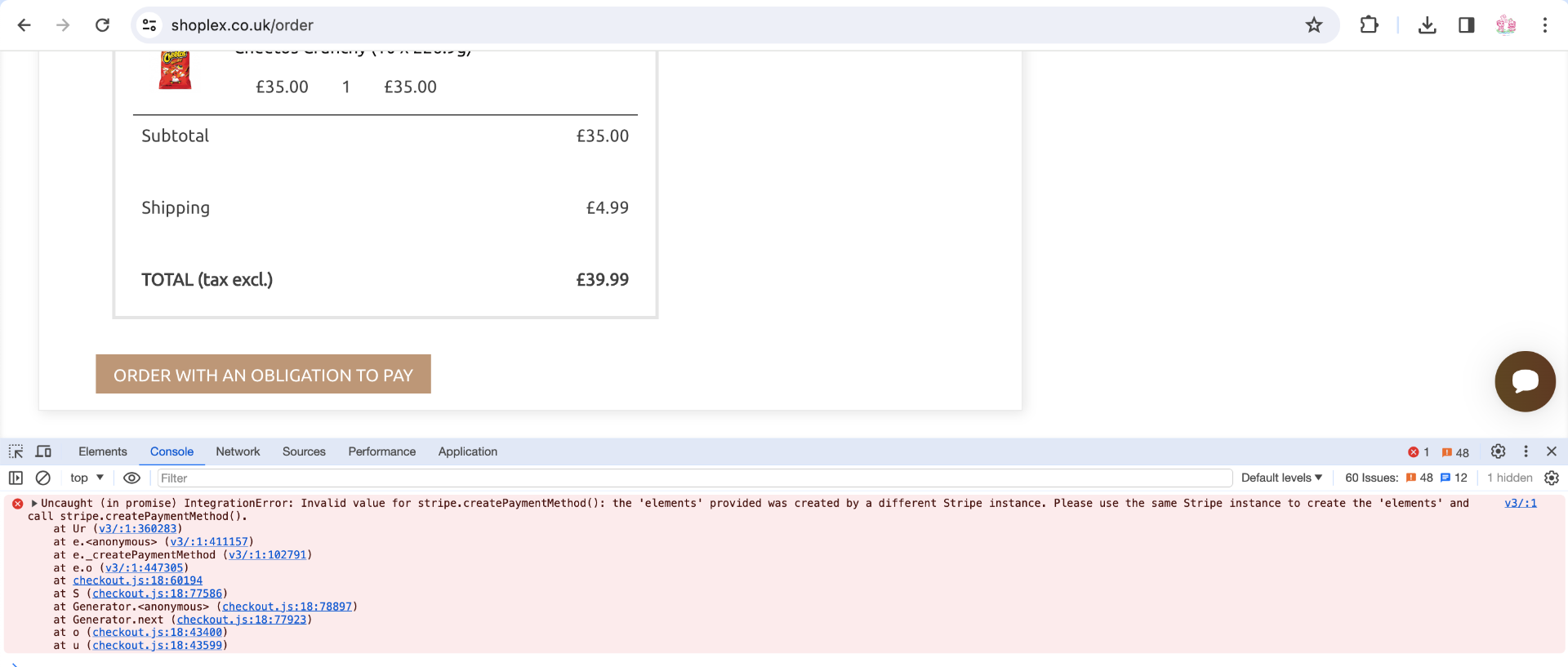

LS136 Posted March 19, 2024 Share Posted March 19, 2024 Hello, I have a bank wire payment set up on my website, it has been working fine for the past few days. I tried to test it today but i am getting the below error in the inspect tool. Uncaught (in promise) IntegrationError: Could not find a mounted element to create a payment method from. at Oe (v3/:1:85179) at e._handleMessage (v3/:1:90713) at e._handleMessage (v3/:1:102981) at v3/:1:88616 Does anyone know what is the issue? I tried resetting but no luck. URL: https://www.shoplex.co.uk Link to comment Share on other sites More sharing options...
Andrei H Posted March 19, 2024 Share Posted March 19, 2024 Hello, If you try and click on the v3/:1:85179 link, you will see that the error is thrown from the Stripe module. The code is loaded from a CDN, therefore even if you did not touch anything in the last couple of days, if the Stripe developers made any changes to that JavaScript, it will be automatically update in your site as well. My recommendation is to disable the Stripe module for a couple of minutes and try another payment with Wire Payment (would be even better if you had a testing website where you could do this). If the Wire Payment method starts working, I would recommend reaching out to the Stripe developers. Link to comment Share on other sites More sharing options...
LS136 Posted March 19, 2024 Author Share Posted March 19, 2024 2 minutes ago, Andrei H said: Hello, If you try and click on the v3/:1:85179 link, you will see that the error is thrown from the Stripe module. The code is loaded from a CDN, therefore even if you did not touch anything in the last couple of days, if the Stripe developers made any changes to that JavaScript, it will be automatically update in your site as well. My recommendation is to disable the Stripe module for a couple of minutes and try another payment with Wire Payment (would be even better if you had a testing website where you could do this). If the Wire Payment method starts working, I would recommend reaching out to the Stripe developers. Hi Andrei, Thanks for the reply, I disabled the stripe module and used a bank wire which worked for me. I am not sure why but my stripe module has been disabled probably since yesterday. When I checked today while I was testing the stripe option was not there. I immediately enabled it. Should I reset the stripe module or will it work automatically? Link to comment Share on other sites More sharing options...
Andrei H Posted March 19, 2024 Share Posted March 19, 2024 Hello, Not sure if resetting it will fix anything. If you enable it and the bank wire option stops working again, I would recommend reaching out to the Stripe developers, as it does seem to be an issue with their module. Link to comment Share on other sites More sharing options...
LS136 Posted March 19, 2024 Author Share Posted March 19, 2024 Just now, Andrei H said: Hello, Not sure if resetting it will fix anything. If you enable it and the bank wire option stops working again, I would recommend reaching out to the Stripe developers, as it does seem to be an issue with their module. Yes, i have enabled it and it stopped working again. I'll try to contact the developer. 1 Link to comment Share on other sites More sharing options...

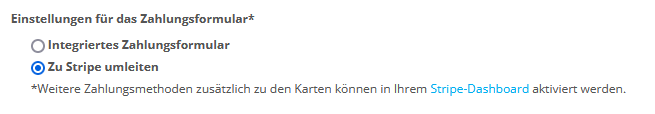

vschichl Posted April 2, 2024 Share Posted April 2, 2024 I have the same problem. My workaround is, that I changed the seetings of the stripe module to redirect online payments to the stripe page (external), then all other payment options will work 🙂 But I hope the stripe developers will fix it ... Link to comment Share on other sites More sharing options...
